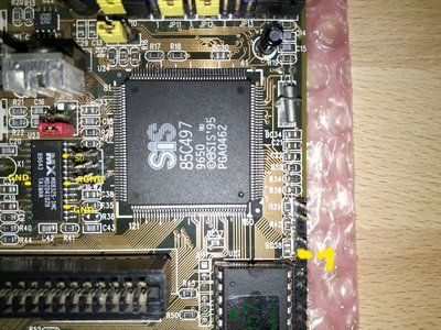

I'm not 100% certain that I know what you want me to do, I attached an image where I checked connections with the multimeter between the turbo pins and the PLL. I did not find any connections for the upper turbo pin.
feipoa wrote:
Is it the keyboard controller which adjusts timing for turbo, the BIOS itself, or the chipset (via command of the BIOS, via command of the KBC?)?
I do not know that. I also did not find a datasheet for the keyboard controller.
Btw, the datasheet stats that the PLL can also do 75 MHz, I do wonder if you can set it to that on the board.
    4.71 MiB
    992 views
Reply 8 of 50, by SSTV2
You need to figure out whole clock switching circuit, that goes in between PLL chip, turbo header and CPU socket with northbridge, there lies your problem. Start tracing PLLs pin 9 and 24 to turbo header, there might be some logic gate circuits that does clock signal switching in logic level.

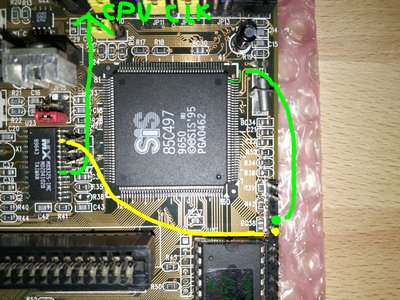

Reply 9 of 50, by Eleanor1967
Just a quick update. I also ran cachechk to confirm the CPU speed and indeed it is reported as 49,5 MHz.
I've previously found out that PIN 26 from the PLL (S0) is connected to the lower turbo jumper pin.
The upper turbo jumper pin goes to the SIS497 chip, but since I did not find a datasheet I have no idea where it is going from there.
I've also found out that PIN 20 from the PLL (BOUT10) is connected to the CPU socket CLK pin.
    2.72 MiB
    918 views
Reply 11 of 50, by SSTV2
Turbo header connects to SIS 497 pin 39 which is "DETURBO" and from there turbo function is controlled by adjusting certain registers bits (165 pg. from chipset datasheet) so the only thing that controls turbo mode is that chip. I think that PLLs CPUCLK mode is adjusted by MS0 pin, when it's high (1), CPUCLK (pin 24) is selected for FSB freq., when it's low (0), then 1/2 CPUCLK (pin 9) should be selected. Perhaps one of the SMOUT pins on SIS497 chip connects to the PLLs MS0? By default MS0 should be pulled high (3.3 or 5v).
Pin 26 (S0) is not connected to the lower turbo jumper pin, it's simply grounded because you've set it so with that red jumper above PLL. If BOUT10 connects to CPU clock pin, then both CPUCLK and 1/2 CPUCLK signals should be buffered through PLLs internal buffers (BIN0,1,2). Figure out to which buffers pin 9 and 24 connects to and where buffer outputs meet.
Also, jumper that JP16 and if turbo mode is controlled in register level, make sure that BIOS are set to default settings, CPU is compatible with motherboard and all jumpers are set correctly. I've also got one motherboard that uses same SIS 496/497 chipset and I can't see any difference between turbo being toggled on or off as long as I load some more demanding software, because in my case, it doesn't adjust FSB.

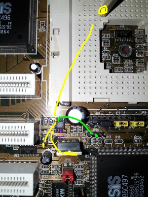

Reply 17 of 50, by Eleanor1967
SSTV2 wrote:
Don't jump to conclusions so early, it's more likely that LDO reg. is bad. Remove all voltage selection jumpers and check for continuity between "outboard" transistors (the one with a heatsink) collector/emitter or source/drain, if it shorts - it needs replacing. Study some application circuits in which a 2951 LDO reg. is used together with outboard transistor, you'll then understand how it works and how can it be tested.
I'm afraid you lost me here. I do not understand enough about electronics to learn how to test that 2951 circuit.
I checked connections with the multimeter and made another artful picture. That's all the connections I could find. I would assume that I should find a connections coming from the 2951 pin 1 (out) to somewhere, could this mean its at fault?
Anyway I have to kindly ask you to help me out here once again since I lack the skill (and time necessary to acquire those right now anyway).
    1.03 MiB
    733 views
Reply 18 of 50, by gdjacobs
The pass transistor is the device in the TO-220 package (standing up with the metal tab). In the simplest sense, it provides (in the context of this circuit) a controllable resistance based on the input from the 2951 regulator, like an electronically controlled rheostat. Based on your drawing, I'm assuming we're dealing with the base or gate (i.e. the control input) on the right most pin (generally referred to as pin 1) which is typical for TO-220 transistors. If the impedance across the other two pins in either direction is less than 10s or 100s of kOhms, the device has likely failed short, should be removed from circuit (and tested to confirm another part in the circuit hasn't failed), and replaced if confirmed to be bad.
Reply 19 of 50, by Eleanor1967
