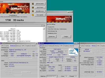

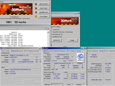

112 MHz FSB was the best I managed with the Tualatin P3-S 1400 on the Gigabyte BX2000+ and this ruined my whole i440BX vs i815 vs VIA Apollo Pro benchmarking and CPU scaling project.
P3-S @112 MHz FSB
264.6 KiB
4194 views
Celeron 1400 @112 MHz FSB
260.87 KiB
4193 views
The P3-S wins out but I think the Celeron would fare somewhat better with a faster video card.

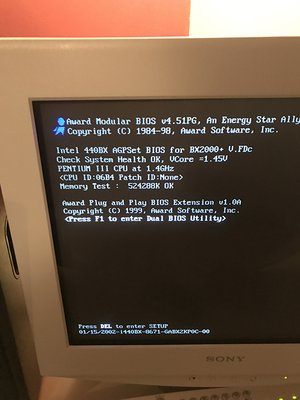

Now conclusion... My friend asked me what exactly CPU I use... and I taken off radiator of slot-T taked of CPU etc... than I realised my CPU was in socket the oposite way... OK... you'll say - you can't put cpu in s370 the wrong way... oh yes you can - if there is a corner pin missing in cpu ;/
It appears that CPU I bought has missing one corner pin...
But this is not the end of the story... After placing CPU in right position system boots, and cpu was recognised but it get allways stuck on screen before memory test... always when the FSB is set above 100MHz... if fsb is 100 system loads, if higher stuck before memory check...
I've tested all the memory i have PC100, PC133, PC150... always the same... I hope it is the matter of that missing pin... I'm waiting for a second Tualatin from a friend - I'll chceck then if it works properly - bul I'll have Scyscraper's post and info about fsb in mind...
Thanks!

I tried two other PIII Tualatin SL5XL and SL6BY...
Situation is the same @fsb 112 (so 1.17GHZ) it runs... and above 112 it get stuck before the memory test 🙁
It seems like fsb jumpers on Upgradeware adapter are not working at all... so motherboard fsb has higher priority... similar with multiplier if I want to set to 14x100 it is seemed as 10.5x100 so 1.05... nothing more.
What else I can do to run it on 1.4?
Help!

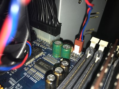

Reply 14 of 47, by Batyra
Tried different cards i.e. Voodoo 3 both PCI and AGP... it boots every time but stuck before memory count...
Once it started!! On all setting "as they should be"... but only once! when I turned it of it didn't want to bood again... So it can boot?!?
Do you think it may be caused by a capacitor? One seems a little bulky, take a look.
I don't see any obvious bulging in the picture, but if you notice it in real life then consider it bad. They don't start to bulge until after they have already failed badly, and they don't always bulge at all.
If it's hard to tell, then it can help to feel several of the other caps and see if you notice a difference between them.
The green caps in the picture look like Sanyos. Those are unlikely to fail, but if they're bulged then replace them anyway. The 3 towards the bottom of the picture are some that I'd be suspicious of. They look like Hermei but whatever they are, they aren't any of the reputable brands. Since they're not one of the good brands, I wouldn't trust them regardless of what they look like.
I would replace those cheaper caps (and all like them on the motherboard), but that's because I'm used to doing it. If you aren't used to recapping then you might be more hesitant. I don't know if replacing them will actually fix your issue, but even if it doesn't, at least that potential failure will have been prevented.
