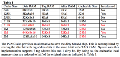

no, long story short, the chips are 256 K bits. So eight of them equal 256 K BYTES. Looking at your board, at the middle left, there is an empty space for a chip. left of the ISSI chip. These 2 chips are your TAG ram. You only have one 28-pin chip. So you are PRACTICALLY limited to 256k L2 (and 64mb of ram). If you populated the left chip with another 256Kb chip like teh ISSI one, then you can upgrade the cache past 256k.

I just checked the datasheet of SiS 85C501,

One 32K x 8bit tag ram is enough for 1M byte cache. The solder points on the left of the ISSI chip might be reserved for a 2M byte variant, or the dirty bit chip.
Reply 12 of 28, by luckybob
If you read the text at the bottom, without the dirty bit you are limited to HALF what the table says. So you only get 32mb with 256k. There are only 8 chip sockets so anything ending in x16 is not an option for this board.
So if you wanted 1mb L2 you need to fill that empty spot with a 32Kx1 chip.
Without the dirty chip the board can still work with 1M byte cache. The cacheable RAM is down to 64MB, which is still more than enough for any period correct application the board can handle.
