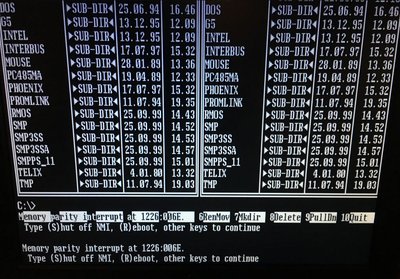

Does anyone know what type of memory the T3200SX should actually use ?
We know that these simms are used in pairs ..and that parity is important .
..and that myself and others had modded larger 30 pin simms which appeared to work in the empty slots ..
I myself thought I had upgraded but am still having parity issues.
A couple of games have been installed on my 3200 ..and launch ok ...but more often than not crash giving a PARITY 2 error ..
I removed all the 30 pin simms ..which vastly reduces available memory ..
Wolf3D no longer crashes when the gun fires ..and so far no parity errors.
..and fwiw seems to run a little faster and smoother.
So ..modded simms may not be the way to go .
JZ ..you have done much the same with modded simms ..
have you had issues ?
If not ..perhaps I should seek out the same memory for modding ...or genuine Toshiba friendly memory ...
though this I fear would be rare.
rgds
VS

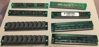

Hi Vipersan,
this chips here, despite having the right amount of pins and form factor did not work in my T3200SX.
I got a error at bootup with any sort of combination.
181.57 KiB
1645 views
Maybe that did not help that much...
best reg4rds
\ chozilla
Reply 2 of 42, by Vipersan
chozilla wrote:
Hi Vipersan, […]
Hi Vipersan,
best reg4rds
\ chozilla
Yep ...I'm not surprised at all Cho.
Once again Toshiba has restricted choice by using proprietory simms..
which is why I wanted to get good close pics of both sides of a 'genuine' working stick
..which _have_ to be fitted in pairs A and B ...
preferably matching.

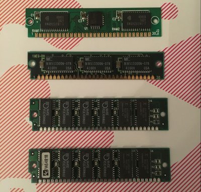

Reply 3 of 42, by chozilla
But there is also some memory that magically works.
Not sure if that is good or not.
146.37 KiB
1627 views
The top two were a pair and the bottom two.
I am leaving the top two out now since my system seems to be more stable.
The bottom two identify as 2MB each so my system is now at 5mb with both.
best reg4rds
\ chozilla

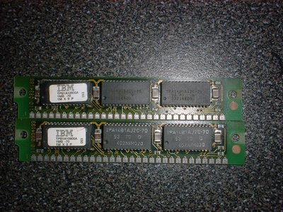

Reply 5 of 42, by Vipersan
So far so good ..
Wolf 3D started and didn't crash ..
Extended memory at boot showed 2mb extra ...and I got to the C:> prompt without parity complaint ..
I found these on ebay at the weekend ..so took a chance.
A matched pair of IBM 1mb simms ?
so maybe I will at least get an upgrade without mods to the simms ?
rgds
VS
I deserve to win the lottery once in a while..
fingers crossed for the 4mb I ordered from the US
    328.56 KiB
    1586 views
Reply 6 of 42, by jaZz_KCS
Have a look at Vipersans other thread. Both my compatible modules and modified ones that work seem to have odd numbers of chips, funnily enough. I think the first ones you posted Chozilla (the ones with 9 pins) could be made compatible like mine. I also provided pictures of the compatible ones it came with they have 3 chips. One for parity.

I'm fairly certain the IBM 1mb simms I pictured above will work very comfortably in the T3200SX ..
So much so ..after locating 2 more in Germany ..I found some more in the US ..and immediately placed an order.
Dare I venture to say ..this has improved the buy and hope lottery for other 3200 users.
Yes there are only six slots that we can use these in ..so a max of 6mb ...but 6mb is far better than than none.
I case anyone also wants to take a punt ..
Here is the US supplier ...
search ebay item :- 131905925586
at the moment I only have 4mb fitted ..and believe me ..these were not easy to find.
rgds
VS

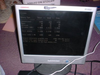

Reply 9 of 42, by Vipersan
Keeping in mind I now have 4mb extended memory ...and hopefully I will be able to upgrade to 6mb
640K conventional memory and a 286 cpu in my T3200sx
640x480 vga
and using a CF card hard drive.
Is it practical to run Windows 3.11
over Dos 6.22 ?
If not ...what are my practical options..
DOS only ..or can I have both.
One for the experts I think
rgds
VS
Reply 10 of 42, by jaZz_KCS
Woah, wait now. The T3200SX is a 386SX16, not a 286. The T3200 was a 268SX12 iirc.
I am running mine (T3200SX) with 6MB extra which gives 7MB total. Even with 4MB fitted (5 total) running Win 3.1 is viable and I am getting good results.
Just keep in mind that with 16Mhz you cannot run demanding games like Civilization for Windows, that would be a slide show. But very early Windows 3.1 games actually run very well.
Whether it's practical, you have to decide. But it is definitely viable.
