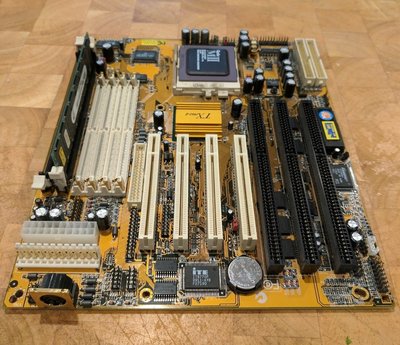

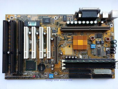

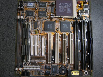

Good luck finding good parts.
I tried that Lucky star LS-486 with no luck. It was DOA. Hard to find a good socket-3 486 board with PCI slots.
FIC also makes a good mobo with PCI slots. But they are hard to find and its a gamble if it will be good or NOT.
I have about 5 dead 486 boards lying around trying to find a good one on eBay.
Also high quality ISA and VLB cards are hard to find and not inexpensive.
With all the computer recycling going on it is hard to find used old computer parts.
I found out that the best and less expensive route is to get a stripped down Socket-7 or Slot-1 mobo.
You want a stripped down one with NO built in Audio or Video that way you can add your own and not have hardware conflicts.
A BX440 0r BX443 Slot-1 mobo. Or a Stripped down Socket-7 Mobo. They run DOS and Win3x and WinNT351 great.
They also run Win-95 and Win-98 just fine. With PCI slots and SDRAM Dimms hardware is inexpensive and easy to find and reliable
They work with ATX Power supplies and modern cases. You can build one for about $300 or by a pre-built and just upgrade the graphics
and ram and audio. Sound blaster Audigy ZS2 or PCI 5.1 live card are inexpensive and easy to find and provide good audio.
You want a stripped down mobo with allot of PCI slots and an AGP slot.
3com 3C509 network cards have good hardware support in DOS and Windows and Linux.
