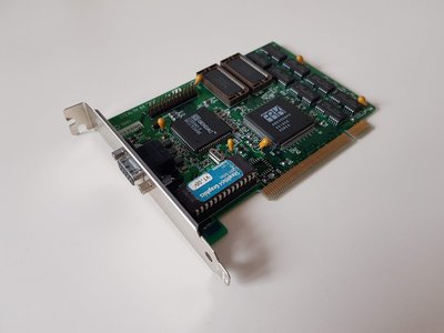

Hercules Dynamite 128 4M PCI added
later, if i have time, i will retest many things.

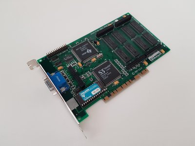

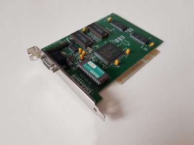

Diamond Stealth 64 2001 2M PCI ARK Logic ARK2000PV added
Diamond Stealth 64 DRAM 2M PCI S3 Trio64 added

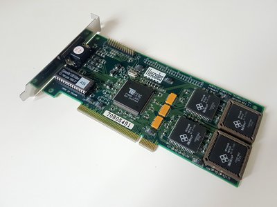

Diamond Stealth 64 Video VRAM 2M PCI S3 Vision968
