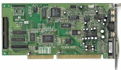

I am think about building a Media Vision Pro Audio computer solely to house my collection of Media Vision cards.
I have these Media Vision cards.
Jazz 16 ( ISA )
Pro Spectrum 16 PAR ( ISA )
Pro Audio 16 LMSI ( ISA )
Pro Audio 16 PAS ( ISA )
They all have a Yamaha 2xx OPL chip too for MIDI play back.
I want to put them in a 486dx motherboard build.
What do you think?

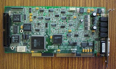

Reply 1 of 53, by Intel486dx33

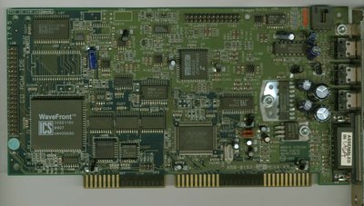

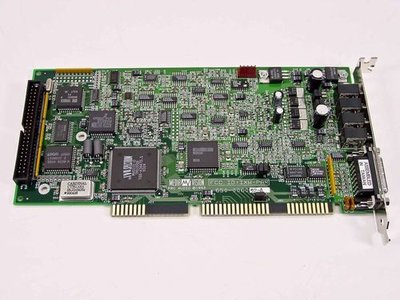

One more card ( 4 total ).

Reply 3 of 53, by GabrielKnight123
I built a 486DX2 66 using Dos 6.21 just weeks ago with a PAS16 and it runs very smooth with the 66 MHz but I dont know about the others (33/50 MHz) so maybe go with a 66 for best speeds for games that need it and I have a turbo button on the front of the case that works well too for anything that needs to be at crawling speed.

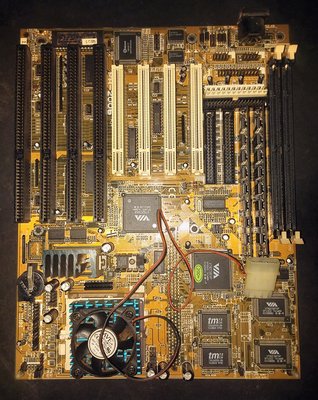

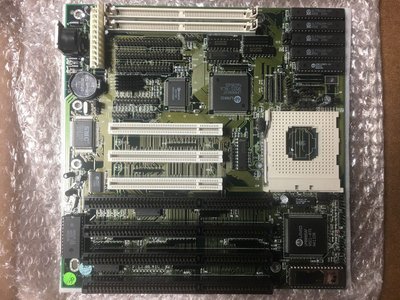

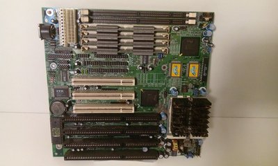

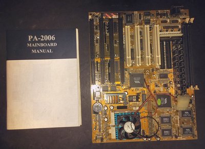

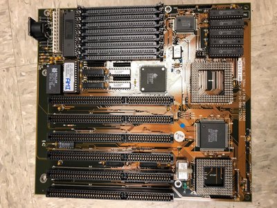

Should I use a Socket 7 Pentium 233mhz. CPU with 64mb+ of ram ?
I have some Socket 7 motherboards that I purchased for cheap and they came with CPU and ram.
Also should I use Win98se with built-in driver support for these Media Vision cards ?

Reply 7 of 53, by gdjacobs
Can you tell us what exactly your objective is for this build? Do you want "period correct"? Any particular software you want to run? Aside from featuring a Mediavision card, are you thinking of a theme?
There's probably 1000 directions to go so you need to tell us a little more.

Reply 11 of 53, by JidaiGeki
Intel486dx33 wrote:
Just want to have all 4 cards working in one computer.
Best setup for audio playback.
Curious why you consider 4 similar or identical cards to give you the best setup for audio playback?
It's bound to get messy having 4x PAS16 cards in one system.
Firstly, make sure your power supply can deliver -5V, as they all require it (ISA Cards & Devices Requiring -5V).
Secondly, running audio from a single CD drive to multiple cards is also going to require a bespoke cable, it wasn't usual for home computers to have multiple multimedia cards in the 90s.
Thirdly, as PAS16s need a driver in DOS, it will be a tangle of addresses and driver names to run even 2 of the cards, let alone 4, as well as memory requirements for the 4x drivers. Win98 might help somewhat, perhaps even Win2K? but it will likely be a fragile setup.
Fourthly, if you're running 4x cards, and only intend to use one speaker setup, you'll need an external mixer, or something to switch sources e.g. a receiver.
It would be enchanting to see such a system built, but it's unlikely to be usable in the way you envisage. Why not mix it up with different sound card types?
On a side note, that Pro Audio Wavetable is so cool, why not focus on getting that up and running? (Media Vision Pro Audio Spectrum and Pro Audio Spectrum 16?)
