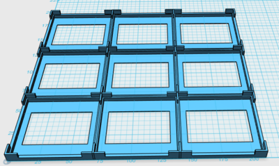

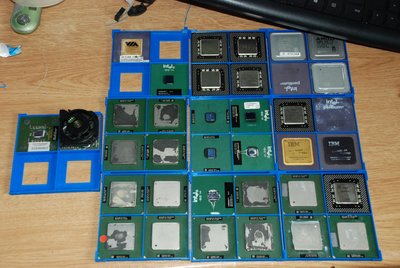

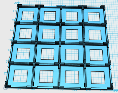

Hi Friends,
i recently made some 3D Printed CPU Trays,
For Sockel 370/A/7/5
71.77 KiB
959 views
75.04 KiB
959 views
The CPU Trays are stackable 😀
Thingiverse Link will follow.
I also will add Design Files for 486 CPU and maybe 386 soon 😀

They are open at the back but it is still not a well thought out design. Things you need to lift up to eject its content should be redesigned. It would greatly profit from openings on the side which allow for taking the CPU's out without lifting up the entire tray.

you can lift up from underside.
its open. With cutoffs the tray will be less stable.
Sockel 5 and 7 CPU's also fit inside. 😀 Socket A too.
it would be cool to get also different cpu's stackable in the same stacking system.
maybe there is some universal measurment which fits many cpu's e.g. 3 Sockel 370 = 4 478 pieces broad ~

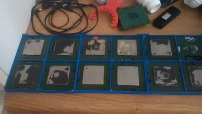

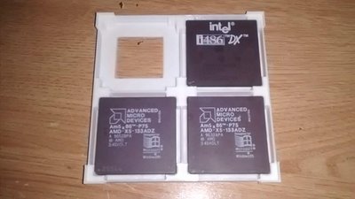

A huge space improvment for me 😀
Now lets make a Socket 478 and S939/AM2 Version 😀

The only thing I would be worried about with those trays is, depending on what you printed them of, static electricity. Commercial trays are made of antistatic materials, but the usual 3D printer filament isn't that. In fact in my experience ABS in particular can accumulate significant charges. I don't know about PLA.
A solution would be to wrap the CPUs in aluminum foil before putting them in trays. This way all pins are in contact with each other and ESD damage may be averted.

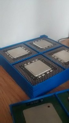

486 Tray.
82.13 KiB
712 views
Simply print with ESD material if needed.. no need to worry about.
1Kg costs around 30 € so its still cheap enough.
Or simply cut out a piece of ESD Foil and put it inside the tray 😜

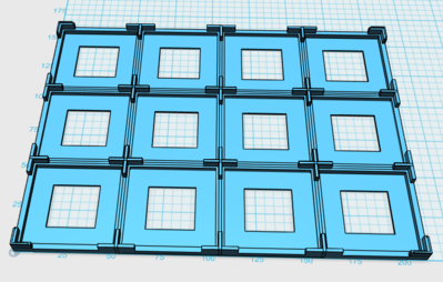

I too have my own for 50x50 (s7,370,462) pentium pro and 486. I am not at home so cant take photos right now.
I was thinking about publishing them too, but design could use some tinkering. Unfortunately say for s370 I already printed over 20 of them and changing dimensions would break stackability. making all 3 types with same outside dimensions so they could be stacked would be cool too 😀
    108.46 KiB
    665 views
    486
    127.02 KiB
    665 views
    pentium pro
    131.47 KiB
    665 views
    socket7,370,462
