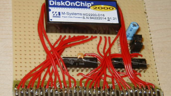

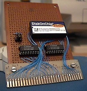

Reply 69 of 70, by Jo22
Hi, sorry for invading this thread again.. 😅
I know of an alternative that may do.
It's unconventional, needs a V20 maybe, but no XTIDE orbany other software.
It's the classic DiscOnChip 2000 module, aka DOC.
It comes with an internal boot loader and 8-Bit I/O.
You can build yourself a simple ISA card with minimal effort.
Or use it on a network card card, I believe.
https://de.wikipedia.org/wiki/DiskOnChip
https://hackaday.com/2018/03/30/a-retrocomput … disk-on-a-chip/
http://www.daupara.de/surfstation/
https://forum.classic-computing.de/forum/inde … er-isa-rechner/
http://hobby-electronics.blogspot.com/2006/04 … p-2000.html?m=1
