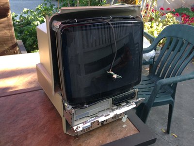

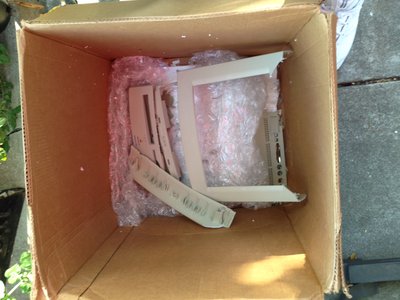

Here are some photos of a Mac performa that broke during shipping because of poor packaging.
So alway emphasize the importance of correct packaging when shipping fragile items.
Lots of styrofoam at bottom and sides, packing peanuts and bubble wrap.
The computer was basically destroyed during shipping, dropped and abused.

Also, that Performa is very sad. People who don't know how to pack CRTs shouldn't even think about selling them in the first place.
