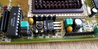

Reply 5 of 38, by Deksor
Well it looks new to me :

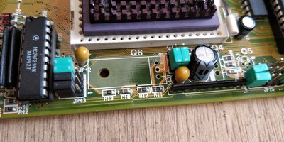

and here's how it was before

The only thing I could think of that might have broken it (even though I kinda doubt it) is that the middle pin was harder to solder because there's much more copper to heat up in that area, but I already installed the heatsink with some solder paste, so the heat was already being dissipated, and I didn't leave the solder tip for more than 10-15s.
There's not much more missing components except "Q4" and "Q5" that are useless if "Q6" (the present regulator) is installed, and some CMS nearby the VLB slots and in the socket that seem to have nothing to do with the CPU voltage (I checked for continuity with my multimeter which gave me hundreds of ohms with anything related to the regulator, and voltages once the mobo was being powered on and that gave me 5V and 12V)
My only bets so far are either my regulator is fake, broken, or is the wrong one

Can you check with the multimeter the trace that connects to pin 1 of the regulator (the one close to the edge of the board)? In case of the fixed version (the one you have), it should connect to ground. If it goes to some resistor it means you probably need the adjustable version of the component as that pin is ADJ instead of GND in that case.
Reply 7 of 38, by Deksor
I get 5V on that trace. I've read the datasheet as well, it's kinda weird indeed, I'm not sure if the documentation is flipped or if there's something else wrong there (Wrong regulator recommended on elhvb ?)
Edit : well, looking at that blurry picture Bought these (retro) hardware today, the regulator seems to be in the other orientation ... That's odd, but that would somewhat explain why ?
Though this is another revision of the board so I have no idea ...
Edit 2: After checking for continuity, the 1st pin seems to be connected to +5V indeed, but the 3rd one don't seem to be connected to the main GND.
I might try flipping that regulator, hoping it's the right thing to do and if so, that it didn't break ! But if so, why did the manufacturer did put "1" on the pin the nearest to the edge if that's the other way around :'(

Reply 8 of 38, by TheMobRules
Yes, the pin locations seem to be flipped, very weird indeed.
I can see that the pin labeled "3" connects to some resistors, which would make sense if it corresponds to the ADJ (pin 1) in the non-fixed version of the regulator. I don't know if a fixed regulator would work in that case, you may probably get a wrong output voltage.
Reply 9 of 38, by Deksor
Well I'll flip it and check which voltage I'm getting in the socket. If it seems allright, I'll try a CPU there
(And if it doesn't, what if I unplug the pin connected to ADJ and get some ground from somewhere else 😁. Probably a bad idea ...)
Edit : flip done, the regulator now sends 4.1V to the CPU core. I've tested with one CPU and it works indeed !
... but yeah that's still too much x)
Actually grounding the "adj" pin might be the (temporary) solution as the voltage on the middle pin is exactly the same as the one in the socket so I guess there's not much done to the output voltage afterall, what do you guys think ?
At least part of the problem is fixed.
To anyone having that board that wants to add 3.3V support : DON'T FOLLOW THE MARKING ON THE BOARD, IT'S PROBABLY WRONG ! Check the voltage on the pins and see which position match the datasheet instead !

Reply 10 of 38, by Deksor
So I did the GND mod ... and it looks fine so far. Now the CPU gets 3.3V as it should. But I'll buy the proper regulator anyways : that mod is ugly and should never be done x)

Now even though it's not really needed, as promised, here are shoots of the board during the mods ^^
Pimpin' a cheap yet promizing 486 mobo :
Here's how it was before any operation.

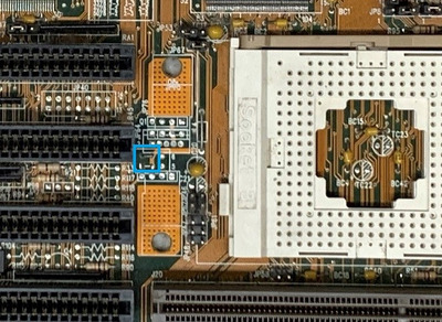

Not too bad, except for that ugly tweak 🤣

Reply 18 of 38, by douglar
Nicely done. You inspired me.
Here's a close up of my shuttle Hot 419 without 3.3v:
142.97 KiB
480 views
Here's a closeup of a board with 3.3v:
161.73 KiB
480 views
http://www.amoretro.de/wp-content/uploads/shuttle_hot-419_dz_r2_486_vlb_motherboard_vesa_local.jpg
I see a transistor, 2 added capacitors, 2 upgraded capacitors, 2 regulators, a bunch of jumpers, 8 resistors and a ferrite.
There's another pair of upgraded capacitors on the other side of the socket.
Seems daunting.
I can take a pretty good guess at the resistors from the stripes, but I'm not sure what to do with the capacitors or transistor without finding someone that has a board with the parts.
