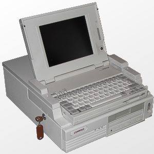

This is a repair project that I REALLY owe my dad! In the early/mid 90's my dad got his first laptop, as the title would suggest, a Compaq LTE Lite 4/33C, complete with docking station. Whilst fighting with my younger brother we broke said laptop, breaking the hinges and tearing the ribbon cable to the screen. When I started on my latest retro trip my dad brought it up and still had it, I brought it home and set about repairing it.
So far I've repaired the ribbon cable and have plans for the hinges, but I'll get to those when it's going back together. Both the hard drive and floppy drive no longer work, I'll be replacing the hard drive with a CF card and adapter, the floppy drive on the other hand I'm a bit stuck with, the belt is no good, it was stuck to the pulleys, I freed it off but it's now too slack, I tried replacing it with an elastic band but it's still not right, I'm not sure if that's the only problem or if it needs more work, but first on the list is a replacement belt, is such a thing available anywhere?
As for the BIOS, it only has a list of hard drive "types", nowhere to manually specify the geometry, the largest drive on the list is a shade over 500mb, is there an updated BIOS that has the ability to change the drive geometry manually (or auto detect), or am I stuck at that limit? I have numerous chip programmers and a UV eraser if required.
How do I go about upgrading the docking station? It has two 5.25" drive bays and a cable for two 5.25" floppy drives, is there any way to add a 3.5" floppy or IDE hard drive?
Lastly, are there any specific drivers required? The trackball will need a driver, will a standard mouse driver work or does it need something specific?

I also have a full size LTE Lite docking unit which I've managed to get a 3.5" floppy drive for (which was very hard to find) and I've even managed to get a CD ROM working on in the secondary IDE connection. There's a little trick with this docking unit. Get a floppy drive. Only genuine compaq models work as you don't want to modify the cables in the docking station if you can avoid it. There's a switch on the back with A/B. This swaps the primary floppy drive to the docking station, making the one in the docking unit become A: drive, and you can then boot from that drive. It took me ages to work that out. Also, whilst you can install two IDE devices on the secondary IDE socket, the bios will not recognise anything that's not one of Compaq's predefined HDD types. But you can mask a drive using EZ-BIOS to trick the bios into thinking smaller drive. The bios is never going to recognise the CD drive, and you've got absolutely no chance of booting from the CD ROM. But there's a cool tool for getting the CD ROM working in DOS/Windows 3.1/Windows 95 called "CDROM GOD" which allows you to go through all the possible drivers - it takes an age, so give yourself a couple of hours, but it gets the drive going.

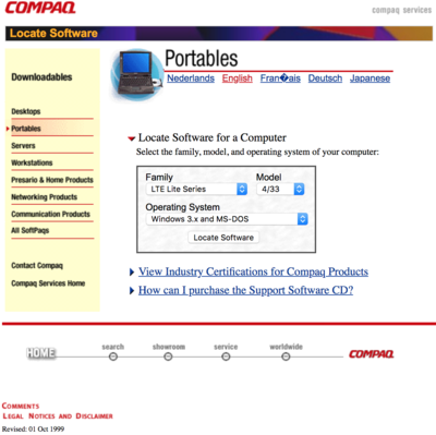

1) The original Compaq driver/utility download page is in the archive. It's tricky to use, but this is what worked for me. Click here for the Compaq.com version and here for the HP.com version.
409.47 KiB
4999 views
1) Select your model and click Locate Software. I've chosen 4/33 as that's most relevant to me. It will take you to this page, which is also in the archive.
https://web.archive.org/web/19991104095546/ht … es/us/1_25.html
605.9 KiB
4999 views

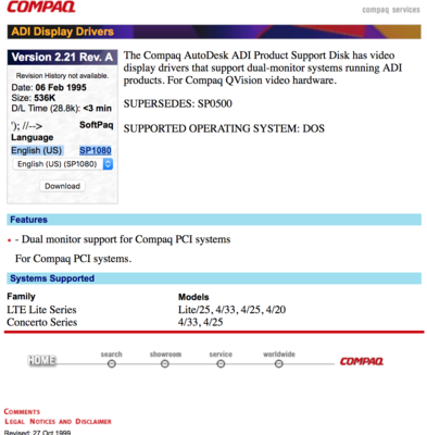

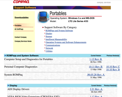

2) Now click on the link in the Current Version column. That will take you to another page like this:
345.87 KiB
4999 views
3) Look in the box on the top right - you'll see English (US) and to the right of that a link that looks like this: SP1080.
4) Right click on the blue link and click Copy Link Location or Copy Link Address. Open notepad and pate the link into there. It will look something like this:
https://web.archive.org/web/19991109235125/ftp://ftp.compaq.com/pub/softpaq/SP1001-1500/SP1080.exe
5) The part of this URL you're looking for is this bit. So extract ftp:// onwards from your link in notepad.
6) Change compaq to hp and make the whole lot lowercase because HP's server is now Linux, so case sensitive. You should end up with something like this. Obviously, the SP numbers will be different depending on which software / driver your downloading.
ftp://ftp.hp.com/pub/softpaq/sp1001-1500/sp1080.exe
Paste the link into a browser and your driver will start to download.
