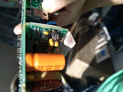

Reply 12 of 15, by talglazer82
Hey nztdm.
I'm not sure I'm following forum rules or whatever.
Just a quick question.
I see you're a veteran on SLT/286 psu.
Following three burnt capacitors on it, I'm currently on my fourth. For the first time I'm stumbled cause I'm not sure which capacitor it was before it blew beyond recognition.
I'm adding photos of the blown capacitor in it's location...
Could you please point me in to the right capacitor?
Thanks! Tal.

Reply 13 of 15, by nztdm
talglazer82 wrote:
Hey nztdm. I'm not sure I'm following forum rules or whatever. Just a quick question. I see you're a veteran on SLT/286 psu. Fol […]
Hey nztdm.
Thanks! Tal.
Hello
I am not quite understanding.
Are you saying the capacitor keeps popping after you replace it?
It's a tantalum. This is happening for one of three reasons:
- you are installing it backwards (measure voltage there to see if the + marking on PCB is indeed correct)
- you are installing a tantalum with a voltage rating too low
- there is a fault in the PSU causing voltage there that is higher than the tantalum can handle
