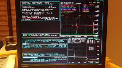

This is picture of my very first test that I just did. There are few things though. I am currently using kingston turbochip there so that is why it shows 5x86 there even if I normally run 486 dx4 100Mhz. Also the hard drive speeds don't seem very impressive probably because after the test I noticed I was using 40 wire ide cable that was leftover from when I didn't have the pci ide card there. Another thing is that I had warning that smartdrv was in the memory when I ran speesys, so that might also affect results. Main thing for me is though that this card supports larger than 127Gb hard drives and it just works on an old 486 motherboard.

Switching from 40 wire ide cable to 80 wire ide cable increased the reading speed from 2800KB/s to 4800KB/s. I assume the low speeds are because of DMA transfer not being enabled in dos.
