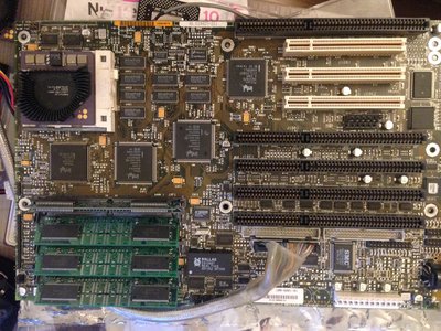

Does anyone have the manual for this socket 4 motherboard or have experience using it? It contains a sticker which says PBA 631022-103. The board powers up, but it identifies my Pentium 66 as a Pentium 60, so I was hoping to find a jumper setting to set the FSB to 66 MHz. Thanks!

That looks like the Intel Batman/Premiere PCI Socket 4 board.
http://ohwc.narod.ru/man-dat/mainboards/intel … ans_revenge.pdf
Reply 2 of 58, by feipoa
Yup, that was it - thanks! It now boots up at 66 MHz. There are two jumper settings for the 60/66 Mhz option. One is for the freq. and the other is for 5.0 V (60 Mhz) and 5.27 V (66 MHz). My board doesn't have this curious voltage jumper. What is the 5.27 V jumper for?
Reply 3 of 58, by vetz
My guess is that you have a newer revision were this feature was either built into the VRM or it was expected that the Pentium ran fine with 5V in both 60 and 66 mhz (as per the specification). I have never seen a voltage jumper on my Socket 4 boards.
There were some early production problems with the Socket 4 Pentium. 60mhz was created since many chips was not stable on 66mhz. Having a higher voltage option on the MB could in theory have 60mhz chips run on 66mhz.

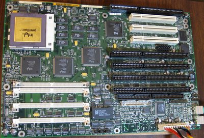

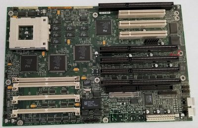

Attached is an image I found online for this motherboard which contains the extra VRM components. You can see the additional components are a toroidal inductor, a large diode, large SMD capacitor, a voltage regulator IC or transistor, two large electrolytic caps, two SMD inductors, and an 8-pin DIP IC. There may be more, but these are what jumped out at me. So this is what it takes to get 66 Mhz going "stable"? What if using an overdrive?
What is curious is the missing PCI bridge chip on this motherboard. Why would they do that?
548.14 KiB
1594 views
Does anyone have one of these motherboards with the VRM components?
I wonder if having a power supply that delivers 5.25 V to the 5V rail would be sufficient. I suppose I could measure the output of my old AT PSUs.

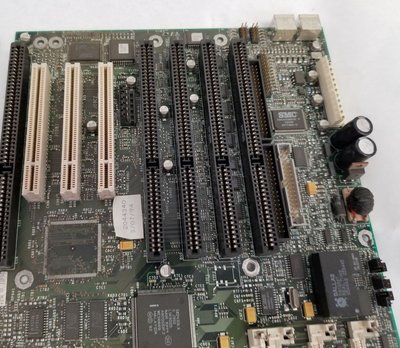

Found an old picture of my board. It also does not have the VRM module. Still works fine on both my P66 and the Overdrive.
2.87 MiB
1524 views
Reply 11 of 58, by feipoa
Interesting to see the subtle differences. Yours has a blue patch cable near U1E1, whereas mine has a black patch cable near the clock gen chip. Yours is also missing U1E1, while my board has this component installed. Yours has the standard KBC DIN, while mine has the minis. If I ever put mine into a case, I'd solder on the standard KBC DIN and put in a header for the mouse.

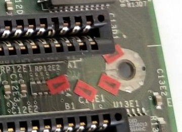

This is what the board looked like on eBay. It has these red arrows pointing to something on the PCB, however I am unable to determine what, or even if there was damage.
524.91 KiB
1509 views
53.12 KiB
1509 views

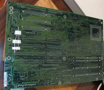

Apparently there was damage. It looked as if a knife had been run across the traces. On the cluster of tightly packed traces, I scrapped off the acrylic layer to expose the copper. Two or three were not making any contact. I re-tinned the traces and rechecked to ensure continuity. However, the gaps on the trio of traces on the top of the photo were spaced too far to bridge with solder. Also, because of the tight spacing between ISA slots, I was unable to solder a 36 AWG wire to them to form a bridge.
398.16 KiB
1509 views
Because of this, I had to find the vias for each end of the trace and patch the bottom of the board with 3 jumper wires. Its not all that attractive, but it works. It could be made prettier if I were to epoxy the jumper wires down instead of using masking tape, but that seems excessive.
