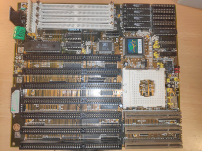

Reply 25 of 33, by GigAHerZ
There is a tiny bit greenish thing around as i haven't done a proper cleaning to it yet. But in general it looks healthy with no broken traces.
I did replace the battery when i received it to a brand new NiMH battery.
Current jumper settings are for 486SX2-50 that i have laying around so easily accessible for testing.
Reply 26 of 33, by quicknick
I have two such boards, both needed some repair near the battery. Keyboard LEDs staying on provide an important clue about the location of the problem - the keyboard controller. One or more of the smaller traces could be broken. Follow each of them, make a "map" of all the connections from the KBC, trace each visually, and with the multimeter check if all of them really connect to their endpoints.
There's no guarantee this will fix the board (well, if you find broken traces near the KBC it surely might), as there could be other problems too... Some broken via, bad solder joints, dead chipset or glue logic.

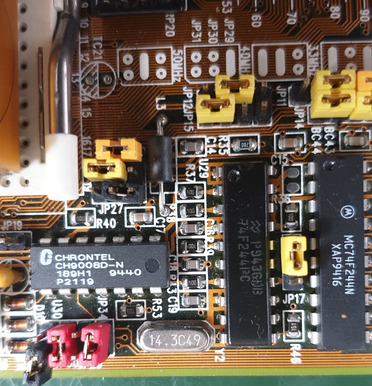

GigAHerZ wrote on 2020-01-04, 00:21:
Hi there. Resurrecting this topic because I had a similar issue. Did you end up fixing your board? I recently purchased a non-working Soyo 025P2 from ebay and was able to fix it easily. The problem was a couple of missing factory-set jumpers. I can see from your provided picture that JP17 and JP27 are set different to mine. Please try setting these jumpers as per my picture below and see if that makes a difference.
Also you mentioned that you have BIOS version J1 (1995) for this board. I am currently on BIOS G2 (1994) and would like to try version J1. Where can I get this please? Thanks.

Reply 28 of 33, by GigAHerZ
Hi Gulzyee!
The bios i got from my board is uploaded here: Re: Resurrecting an Socket 3 motherboard (Soyo SY-25N)
Other bios'es are also uploaded into this forum thread here.
I'll check the jumpers when i have a chance and will report back. Thanks!
Reply 30 of 33, by GigAHerZ
Though, some time has passed, the board has not resurrected.
I've checked all the jumpers, tried different settings and i have 025P2 board side-by-side with it, yet this dead board stays dead - keyboard lights stay on, debug card shows nothing, etc. 🙁
Possibly only worth to salvage parts... 🙁
