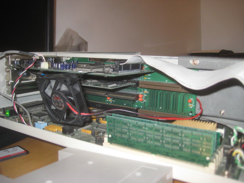

I'm bit worried about how to make it work without overheating the voodoo 2 cards.
Situation would pretty much be this in a tower case.
ISA sound card at the bottom of the case for dos (only ISA slot on the motherboard)
Empty pci slot above the ISA sound card.
Voodoo 2 card above that empty slot.
PCI sound card for windows above the voodoo 2 card. (not installed yet)
Another Voodoo 2 card above the PCI sound card.
2 Slot video card at the top in the AGP slot. (hasn't arrived yet so I have temporary single slot passively cooled card currently in the agp slot)
Cooling?
The psu at the top of the case seems to sucking bit of air from the outside to the inside the case...
I ordered 2 good fans for the case 92mm fan for the back of the case above the cards that I would put suck hot air from inside the case to outside and 80mm case that would suck air to inside the case at the front of the case. These fans have not arrived yet but should come within next week.
Is this enough cooling for the voodoo 2 cards? I feel like they will be tightly packet inside the case when I put the PCI sound card in between them.
Is there anything I can do to improve the situation?

Voodoo2 cards don't really get that hot.
Most your need is some stick on heat sinks and fan's.

I just watched recently Phil's video on youtube where he measured 85C surface temperature on the voodoo 2 card chip even on open test bench. That is one thing that made me worried. He only used one card in open test bench after all.

In my case 2 x 140mm side-panel mounted fans blowing directly onto the expansion slot area, with the V2s right in the middle. High-airflow Corsair near-silent models, if that doesn't keep them cool nothing will. I do the same with the V5 except I also load that one up with heatsinks on the rear of the dies and on memory chips, it gets much hotter and I don't trust the stock V5 fans.

In my case there are some air holes in both of the side panels, but unfortunately there is no place to attach any fans to.

I bought cases specifically for retro build with this capability, see this post for a pic with one fan and the V2s:
It was the only new/modern case I could find for sale that was barely sufficient for retro computing: minimum 3 drive bays, 2 horizontal 140mm side panel fans, forward facing USB ports on the front, full-ATX, etc. I wish it had one or two floppy drive bays, but good luck finding all that today.

I was even looking into something like zalman fb123, but I couldn't find them in stock anywhere.
Anyone has any ideas? Would small heatsinks on chips in those tight spaces between cards matter much?

That would probably do it. The other option is to get one of those kits on eBay for about $5 that allows you to link 2-3 80mm fans and insert them into a PCI and blow them directly onto the face of the card. But they take 2 slots and not really suitable for 2 cards, but I use them both for a 5950U and a V5-5500, mainly in case the actualy GPU fans die one day.

Open air is not the same as in a case. Wile 85c is hot most GPUs can take upwards of 80c fine.
Id have to take a look at the specks of the voodoo2 chips, but I recall they were rated between 70c and 80c.

Don't over think it, all you need is some sick on heat sinks if you case has fans and OK air flow. Not many people even have more then one case fan back in the 90s, let alone stick on heat sinks on their voodoo2s.
I believe the voodoo2 chips are somewhere around 25 to 30mm. I could be off but I think they are 27mm chips. Anyone with a voodoo2 handy want to tell me if I'm right?

Would it matter if the hearsinks would be bit bigger than the chips themselves? I saw some nice looking heatsinks online that were 40mm x 40mm x 11mm
Edit: I think I am just bit worried about them falling off at some point on top of the next card below the voodoo 2 card.
Reply 14 of 34, by Mr. horse
As long as it fits it will be ok. Smaller or bigger is ok. The more surface area the better however.
And no they will not fall off if you install them right, if you get the ones with the 3m thermal tape your likely pull the chip off the PCB if you tried to take the heat sink off. Its some really strong stuff.

For mounting a fan I use cable ties and hang them off the holes in the corner from the card above
Alot of people simply mount a fan to a PCI bracket and bend to the required angle. The bonus is you can screw it in a shared spot as a populated PCI slot if needed.
