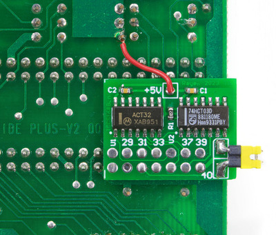

RayeR wrote on 2022-12-13, 15:39:
Hi,
I succeed to make a simple IOCS16# decoder using 2 log. gates IOs 7432 and 7403 (simple grounding of IOCS16# is no go as only data register requires 16-bit access and other regs. needs 8-bit). Now the SSD is identified properly and works fine on that ancient 386 with XTIDE BIOS. I plan to make some compact PCB with SMD parts that could be “glued” to backside of old IDE controller 40-pin header. Thanks to rasz_pl for valued posts helping to solve this puzzle.
Here are some photo and schematic diagram of decoder:
Excellent. Applying De Morgan's, you can make the circuit using only NOR gates: //(//(//(DA0+DA1)+//(DA2+CS0))+/CS1). Unfortunately, by my count this is nine gates, so not as chip efficient as your option.

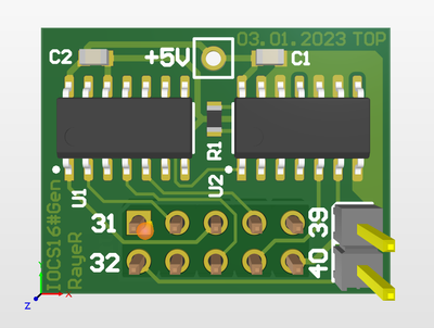

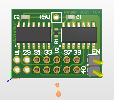

Hi, I made a small PCB for IOCS16# generator circuit intended to place on backside of IDE controller's header, so this is why routed on one layer to make bottom insulated from other pins on controller's backside.
EDIT: oh I see I should add more holes for IDE header pins before 31, 32 to pass them through PCB, will be updated...
Gigabyte GA-P67-DS3-B3, Core i7-2600K @4,5GHz, 8GB DDR3, 128GB SSD, GTX670(GF7900GT), SB Audigy + YMF724F + DreamBlaster combo
Reply 49 of 54, by Sphere478
Oh that’s clever. Did you enlarge the holes a little so they fit on the solder cones?
Sphere's PCB projects.
Reply 50 of 54, by RayeR
Yes, I should enlarge them a bit over standard header footprint holes expecting bare pins...
Well, PCB updated...
