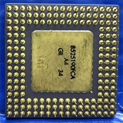

I am looking to buy an Intel 486 DX2 66mhz CPU on eBay.
I found one, but some of the pins are a little bent.
Can these pins be successfully bent back, or should I just skip this CPU?
Here is the seller's picture.
Thanks!

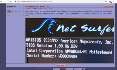

Windows9566 wrote:
i had 2 pentium 90 CPUs ...
Dude, your signature is ridiculous... this is literally how it looks on my display (with the browser window maximized):

Reply 10 of 23, by Windows9566
SW-SSG wrote:
A mechanical pencil after taking the lead out works very well for Socket 3/4 chips, but often the newer sockets put the pins too […]
A mechanical pencil after taking the lead out works very well for Socket 3/4 chips, but often the newer sockets put the pins too close together to make this realistic.
the net surfer bios logo was on a Intel TC430HX, i thought it looked cool so i took a pic of it.

Reply 18 of 23, by appiah4
The CPU in OP's photo has more straight pins than the most straight 486 CPU I came across, and I managed to straighten up and fix every single one of them. Go buy it.

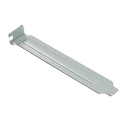

Reply 19 of 23, by Intel486dx33
I use a computer back slot cover to get the pins lined up and tweezers if they are really bent.
