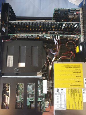

I recently got an IBM 5170 with an 5154 EGA screen. The unit was dirty as hell but cleaned up nicely 😀
When the PC is attempted to be started the green ON led will flash once and the harddrive will click once (at least i think its the harddrive). The PC will then turn off right after. One can also see the rear fan of the PSU almost turn before it shuts down. Im guessing its a PSU failsafe, and that there is a short somewhere. I have tried starting without the diskette drives and HD connected to power, but the same happens.
Anyone know if my PSU is dead or what else might be the case?

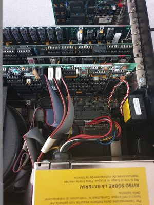

Here are some pics:

Reply 4 of 20, by SVD
I started pulling cards, and I found the culprit. The PC starts without the HD/Floppy controller card.
What could be wrong with it?

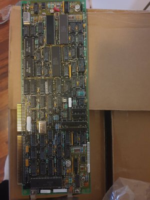

Here is a pic:
296.92 KiB
422 views
Reply 5 of 20, by retardware
Still not sure whether it is the PSU which possibly can no longer deliver its full rated output due to aged capacitors or an actual defect in the card.
To establish whether it is the card you should try to take off other loads and try with the card installed.
For example, the stickers on the PSU indicate that only 2.8amps should be drawn by the HDD. However there were 5 1/4 FH drives that were rated at 4+ amps at 12V.
Reply 6 of 20, by SVD
The first thing I did was pulling the molex conectors from the diskette and hard drives. The cards where still in. This is the only card that changed anything.

SVD wrote:
I started pulling cards, and I found the culprit. The PC starts without the HD/Floppy controller card. […]
Here is a pic:
Are those axial tantalum caps I see ? I have heard tantalum caps have a tendency to short when they go bad .
Reply 12 of 20, by Ozzuneoj
I had the same problem with a new old stock Everex EGA card. It had a shorted tantalum (silently failed... it didn't blow or smoke) which caused my 5150 to have a pretty similar problem. It wouldn't turn on. After replacing that cap (I just used whatever standard electrolytic I had laying around that was a similar value) the card has worked fine for three years now.
If i were you I'd check for continuity across the leads of each tantalum cap. If any are shorted, replace them.
Reply 13 of 20, by SVD
retardware wrote:
SVD wrote:
My card have some extra cords on it for some reason compared to the one on ebay.
Which ones? I only see the FD/HD and LED connectors.
Maybe post the image of the card you saw in the bay so we can make sure it is compatible.
The yellow lines near the big chips. Link https://www.ebay.com/itm/Vintage-IBM-MFM-Fixe … vIAAOSwowdckW9w
@darry @Ozzuneoj
Ahh thanks, i measured 1,1 Ohm on the big yellow cap C46 right in the middle of the 8bit part of the ISA slot. Is that normal?
EDIT
0 Ohm seems to be 1.0 ohm on my measurement thing, so I guess the cap is 0,1 ohm. Thats a short I would think.
Reply 14 of 20, by Ozzuneoj
SVD wrote:
The yellow lines near the big chips. Link https://www.ebay.com/itm/Vintage-IBM-MFM-Fixe … vIAAOSwowdckW9w […]
retardware wrote:
@darry @Ozzuneoj
EDIT
I mainly just look for shorts (0 ohms; or a beep on my continuity\diode tester). Beyond that, I can't say for sure. I've just been learning this stuff by experience... I'm definitely not an engineer. 🤣
I see it doesn't really have that many tantalum caps. I think the bullet shaped cylindrical ones like C45 and C46 are tantalums, but the picture isn't quite clear enough to tell what type the others are. I don't think the small-ish yellow ones that are sort of irregularly shaped are tantalums. I think those are called "resin dipped ceramic", which should be nothing to worry about. I'd check any other bullet shaped caps. I don't think any caps should should ever be shorted, so it should be easy to tell if one is causing this.
Reply 15 of 20, by retardware
Factory patches, it is a bit older version than that in the bay. The latter one already has them incorporated in the PCB.
Solder off one leg of the cap and measure the caps' resistance again.
The small resistance of 0..1ohm often is just the oxide layer of meter tips and solder surface.
If the cap measures that way with one leg off (to exclude other shorts causes), then it is indeed the culprit.
Reply 16 of 20, by SVD

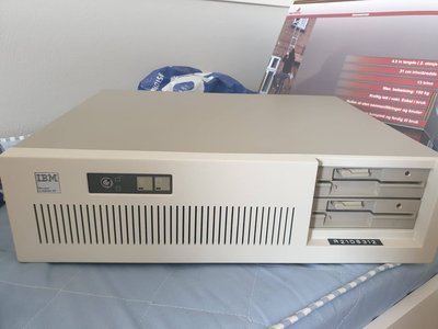

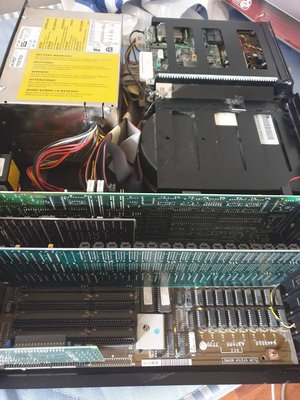

Hi again, just to update. I have finally come around and changed the cap. Now its working! So thanks for all your help bringing this beast alive 😀
272.11 KiB
263 views
379.92 KiB
263 views
The new cap is the second to the left of the battery wires. Also I have installed a BOCARAM/AT card with 1 MB, so now I have over twice the RAM I will ever need 😁

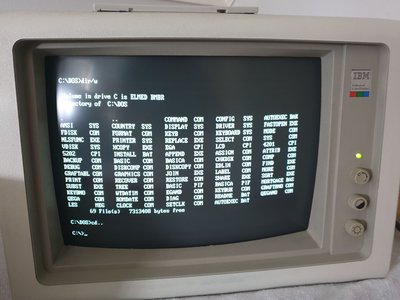

Reply 19 of 20, by SVD
Yeah its always the caps 😀
The 5154 got really brilliant colours ^^ They seem to be a bit expensive and hard to get tho, none on ebay at the moment. I got it with this AT computer and a Cherry G81 keyboard for 200€, someone was getting it for 150 but i overbid them, still cheap I think. I thought it was a 5153 until i went to pic it up. 😁
The contrast knob does not seem to work tho. But its at an okay level luckily.
