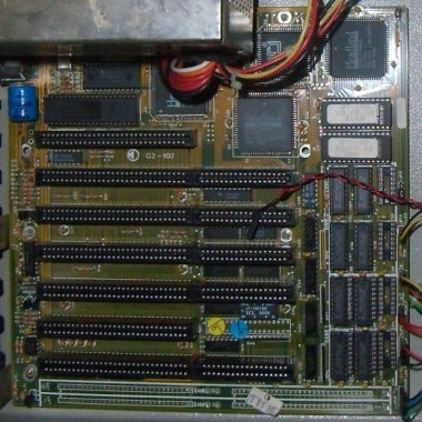

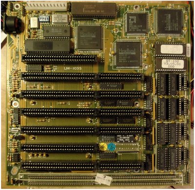

I'm looking for 286 BIOS image - Quadtel QT-102 V3.05.1. I can't find it anywhere 🙁
This or I'm looking (willing to buy) for the whole motherboard with this BIOS - namely LM-103S or (even better) G2-102 motherboard which is pretty much the same…

Yup, it's very similar to CDTek mobo you linked to (in a matter of fact I have exactly the same CDTek mobo in near-mint conditio and I want Quadtel BIOS to swap the AMI one installed in it purely for nostalgia purposes 😁). I don't have LMS-103S/G2-102 motherboard unfortunatelly, but I had one back in the 90s.

I happen to have an LM-103S (with its manual) but, unfortunately, it's already had some battery corrosion (I did remove the barrel battery when I got it).
Surprisingly, when I tested it the other day, it posted.
I'm more than happy to dump the BIOS images for you with my EPROM reader (I'm not sure what the BIOS revision is).
Sure! Please dump them if you can. You can also use Navratil Software for dumping it without removing EPROMs. http://www.navsoft.cz/products.htm
