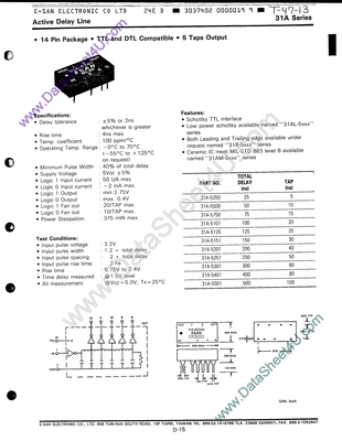

I managed to find the datasheets
224.1 KiB
442 views
Kappa Delay Line.pdf
59.24 KiB
19 downloads
So the ESAN seems to be 5 TAP, 100 ns total, 20 ns each TAP.
KAPPA seems to be 5 TAP, 150 ns total, 30 ns each TAP.
I was rather surprised these are not available anymore and there seems to be no cheap replacement? Only match seems to be the DALLAS/MAXIM DS1005 where I found one dealer for the 100 ns who ships from China for 5EUR each...

Reply 2 of 8, by retardware
These delay line chip actually seem 74LS14 with some pins snipped off, "repackaged" and sold for much more money.
74LS14 are Schmitt triggers which have a delay of typically ~15ns, 6 cascaded of them make the ~100ns you want here.
The small tolerances do not really matter for the creation of the DRAM timings (RAS, CAS etc), I used the LS14 myself for my DRAM cards back then in the 1980s.

Reply 5 of 8, by retardware
Deunan wrote:
I'd advise agains LS chip as delay lines. The H->L transition is much faster for TTL tech than L->H. HCT is much more uniform, better idea I think.
As the signal gets double inverted each stage, wouldn't this even out?
Predator99 wrote:
For the 74LS14 the delay seems not to be very specific? Its between 5 and 22 ns according to the datasheet. But if it doesnt matter it seems to be interesting.
Well this unspecificity made me wonder when I searched for a way to generate the delays I needed, and this was why I first used the LS14 in 1981. Instead of just cascading the inverters to get a roughly appropriate timing (as I did it back then) you might use a complicated contraption of wires and capacitors to get more precise timing, like described in the delay line's data sheet.
I don't think you need to take the effort of using the LS31, as the delay line package dimensions clearly indicates it was no '31 inside.
The LS14 was quite commonly used back then on ISA memory expansion cards, so I guess it might be worth a try.

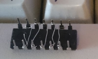

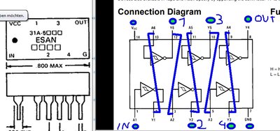

Reply 7 of 8, by Predator99
Took again a look at it and LS14 seems to be a good choice. Only need to do 5 simple wire connections and the result is pin-compatible to the delay line.
I have ordered some and will try - thanks again! 😎
136.73 KiB
284 views
Reply 8 of 8, by Predator99
Dont have a soldering iron here, therefore I made a quick&dirty fix 😈
948.86 KiB
213 views
Result here...:
