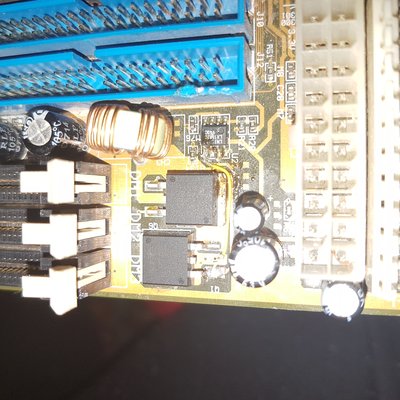

Reply 19 of 23, by PcBytes
PcBytes wrote:
and I have noticed that there's a ticking around the MOSFETs between the SDRAM slots and the ATX power plug. This becomes more evident as the following happens when I measure with my DMM on any of them:
-Drain will produce a intermittent beeping
-Source will either yield ticking or a continuous beep with ticking in the background
?? you measured continuity on powered on board?
what are you measuring exactly? drain and what? source and what?
the only thing you should measure is drain-source junction, you can simulate turning mosfet on (after desoldering it) by briefly charging gate, but its usually not needed as mosfets love failing short[/quote]
Here's a photo of the section I measured.
file.php?mode=view&id=62315&sid=58a1f6add49c4b5e52a7cfdb4c34f4fd
The nearest to edge of board MOSFET I am feeling is shorted - measuring the Gate-Source junction I get a rising resistance, while the same test done on the other MOSFET next to it will result in a beep (low resistance). Both MOSFETs are the same brand and model - NEC 2SK3296.
Disregard the wire going from the Drain tab to the 8 pin IC - I did that to bypass a trace I accidentally broke.
