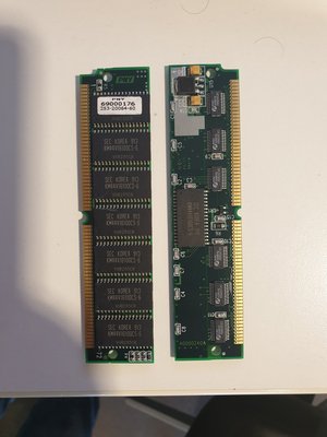

Reply 2 of 11, by claesbas
Thanks for the reply.
So on the chips it says: SEC KOREA 913 KM44V16100CS-6
and on the sticker it says: PNY 69000176 253-20064-60
Image:

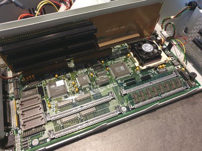

And my Chipset is (Via or Sis) I am not sure:
1.78 MiB

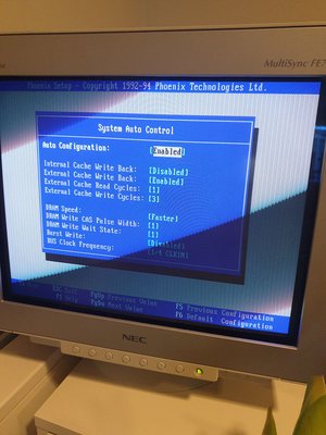

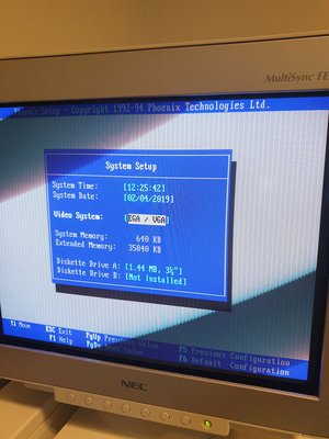

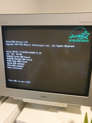

Reply 3 of 11, by claesbas

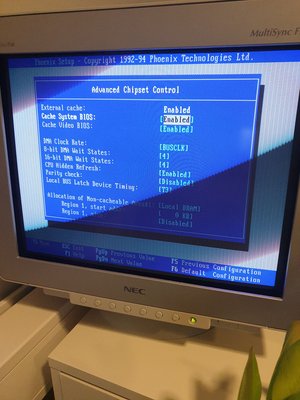

Some images of boot + bios settings:

Reply 4 of 11, by dionb
claesbas wrote:
Thanks for the reply. […]
Image:
Fortunately a totally different SIMM to the eBay images. Lazy/lousy seller, but at least not trying to sell 4/8MB SIMMs as 64MB.
KM44V16100CS-6 is a 16Mx4 chip, i.e. 64Mb, and eight of those make 64MB (or nine in this case as it's a parity module). So the SIMM checks out: single-sided (as 32/36 address lines, regardless of where the chips are physically located) 64MB parity SIMM.
Interestingly - but not relevant here - the chips are 3.3V and the SIMM has an onboard voltage regulator (that MOSFET) to drop from 5V SIMM voltage to 3.3V chip voltage.
Why not sure, it's right up there in your pic, SiS 471. Which is rather old and almost certainly why you're not getting the full 64MB out of these SIMMS.
Here's the datasheet:
ftp://retronn.de/docs/chipset/SiS%20471.pdf
Fast Page Burst Mode DRAM Controller-4 Banks up to 128MB of DRAMs-256K/512K/1M/2M/4M/16MxN DRAM Type
There's your problem. Just to confuse you, the "M" here is almost competely unrelated to the "M" in chip density. This simply refers to the number of MB per bank. A single-sided SIMM is one bank, a double-sided SIMM fits two banks. Max for one bank is 16MB, and that's what your 64MB SIMMs are showing up as. What this actually means is that the SIS 471 can handle a max of 16Mb chip density. To get 128MB on this board, you'd need four 32MB dual-sided (64/72 address lines) SIMMs.

This isn't a single/double sided thing but a memory density thing. This chipset won't recognise chips over 16Mb. A consequence of that is that to reach the amount of memory you want you have to do it with a different type of (double-sided) memory, but that's effect, not cause.
By the way, you might not even want to add that much memory to the system with your current cache configuration. I can't see exactly what cache chips you're using on the motherboard pic but one screenshot shows 256kB. Check pages 7 and 8 of the SiS 471 datasheet. The amount of RAM the motherboard can cache depends in the amount of cache present and the tag configuration. You have 256kB cache, which means either 32MB (7b tag) or 64MB (8b tag) is cachable. Rule of thumb to determine 7b vs 8b: count the cache chips. If you have an odd number (power of two plus one, i.e. 4+1=5 or 8+1=9), it's 7 bit and the lower limit applies, if it's an even number (power of two plus two, i.e. 4+2=6 or 8+2=10) it's 8 bit and the higher limit applies. Either way, your board can't cache over 64MB and maybe not over 32MB. Uncached RAM access is slower, so unless you are actually using all that RAM (highly unlikely on a 486 desktop) going over that limit will make it run slower than it does now with 32MB.

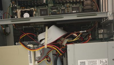

Can you see in this picture what cache I have?
883.79 KiB
1058 views
Reply 9 of 11, by dionb
The picture is much too blurry to make out the chips,but it looks like nine of them in any event, so I suspect 7 bit. That means max 32MB cacheable with 256kB cache like you have.
