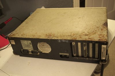

So I bought an old 5150 that has obvious water damage throughout. The PCB and traces look ok (though I haven't pulled it out just yet), but the case is badly rusted in two key spots and many IC's on the motherboard have green corrosion / rust on the leads.
I can guess on what a lot of the repairs I'll need to do are, and I realize that I may not be able to get this working again, but I'm curious to know if there's any good guidance on dealing with corrosion issues like this - general approaches / best practices, etc.
Also, the steel case is so badly damaged, I've been thinking of having it sandblasted and repainted. Is it possible to color match IBM factory colors? If so, how?

I know there's a good chance it's beyond hope, but despite the corrosion on the IC leads, there's no evidence of damage to the mobo or traces, though I've yet to pull the board and put it under some magnification.
As for the case, I can't presume to reasonably restore it to factory condition, at least as far as the texture is concerned, but maybe a good match on the color will be satisfactory.

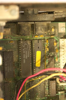

Closeup of CPU and copro socket. Corroded / rusted leads on most IC's
Reply 3 of 10, by luckybob
oh, i've seen worse. Not much, but this is salvageable.
The question you have right now; how deep do you want to go down the rabbit hole in terms of time and money? This machine can go either way. It can be restored, at significant expense, or it could be used for parts to restore other machines.
In any event. I'd take the big pieces apart and wash everything down. Clear the dirt to just see what you are getting yourself into. Dont get the speaker or any motors wet, but the cards/motherboard can literally be put in the dishwasher. Just get the big chunks cleaned.

I keep tossing the rabbithole question around, myself. Not sure how far I want to take it, really. I've got nothing but time, so I can solder / desolder to my heart's content. I'm not super experienced, but I've got a decent gun and know how to use a desolder braid. 😀 I've done a couple recaps and I'm generally not afraid of trying. Given the condition of this piece, I'd not be heartbroken if it turns out unsalvageable or just a bit out of my reach. I don't see evidence of trace damage on the motherboard, though I haven't got it under magnification just yet.
I need to figure out logic testers, too - I'm thinking that'll be a pretty critical element in moving forward on restoring the IC's, unless the assumption here is that they're all likely going to get tossed... Really, the value of bringing this thing back is just learning, I think. I imagine I'll know quite a bit about how a 5150 works by the time I'm done.
The power supply popped a cap when I plugged it in (unplgged it from the mobo first, of course), and I've never dealt with rehabbing a PSU before. I suppose that's the first order of business...

Thats just fine for 9/10 things you will run into on these. Right now, I'd clean what you can, and reseat all the parts possible. Make sure all the sockets are free of green fuzzies. This stuff is mandatory: https://www.amazon.com/Hosa-D5S-6-DeoxIT-Cont … =gateway&sr=8-3 and a cheap toothbrush

I'll keep it in mind. As I look over the IC's one of the worst is the 8088. Several leads have rust at the top right next to the chip, which doesn't seem like a good sign. 😒 In fact, at a glance, I would be inclined to think that it might be the only chip that won't run... If so, I may go hunting for a NEC CPU. I did that with my PS/2 - generally pleased with the result. That is, unless you can sub in an 8086 in a 5150 😀
