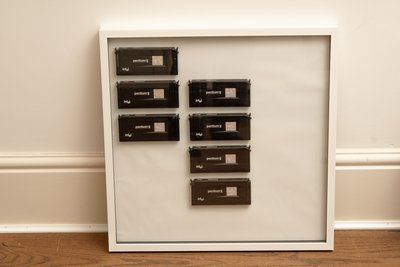

I decided to display my PII CPU collection on a wall. My better half picked a frame and place in our house where this project will be tolerated. So I have just and only 50cmx50cm of space which I would like to fill with Slot 1 stuff from my collection.
I started putting together a layout. I thought it would be nice to display these CPU's in a nice grid. Would be great if all those CPU's are somehow significant and create a set or multiple sets.
My current version looks like this;
1.44 MiB
459 views
(1st column, PII Klamath 233, 266 and 300).
2nd column PII Deschutes 266, 300, 333, 350, 400 and 450. Currently the 266 and 450 is missing, thus a gap in first and last row, but hope I will have them soon.
Now the question is how to continue and how to fill rest of the space. Should I display Celerons or Xeons? Or a few with open cases? Or should I start adding PIII's? Ideally I would like them to look uniform and this should be a closed set and should make sense.
How would you fill a 50x50cm space with PII stuff? Any thoughts appreciated.

well, just so you know xeons are exactly 2x as tall as the lowly P2. but there are only 2 iirc, 400 & 450, but3 different cache sizes, 512k, 1mb and 2mb. (6 total if you want to be a completionist)
As for the celerons, theres the 266 & 300 covington, mendocino is kinda outside of your area and would be a gen2 p2
gen2 p2's are the 350,400 &450
and gen 2 celeron (mendocino) were the 266 through 433. (in slot 1) The 300a almost deserves its own special case tbh.

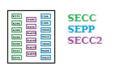

I rigged something together quick.
A suggestion would be to have 3 columns, arranged like this:
Column 1:
Klamath 233
Klamath 266
Klamath 300
Deschutes 266
Deschutes 300
Deschutes 333
Deschutes 350
Column 2:
Deschutes 400
Deschutes 450
Katmai 450
Katmai 500
Katmai 550
Katmai 600
Column 3:
Covington 266
Covington 300
Mendocino 300
Mendocino 333
Mendocino 366
Mendocino 400
Mendocino 433
I'm suggesting this as this particular arrangement would be more visually pleasing to me (even though I would've probably placed the SEPP CPUs in the middle column, but then the numbers don't match up as good but you get the idea 😜). The CPU frequencies are not very important when displayed by this as it will be hard to see at first glance 😀
I'll add a makeshift quick cobbled together paint 😜

Reply 3 of 13, by mpe
Thanks.
I like the idea of putting a separate SECC2 column to the center. More so than filling the space with Xeons.
It is a pity there is no space for SECC 400 & 450 though 🙁
Will need to source the SECC2 variants of 400 Mhz & 450 MHz PIIs which I currently don't have in my collection. Also not sure if my 600 PIII is Katmai or Coppermine, need to check that out.

Reply 9 of 13, by mpe
H3nrik V! wrote:
So, are you aware that in SECC2, you'll also have variants on the CPU die itself? 350 and 400 are made both in PLGA (metal cover) and OLGA ("open" die). 450 is only made in OLGA AFAIK.
Oops. I didn't know about PLGA/OLGA thing. Now I know and it is going to be a problem 😀 My composition won't feel complete any more. Perhaps I should ditch Katmai and focus on making PII a(SECC, SECC2) + Celerons as complete as it could be?
There could be also another thing. I suspect that some PII have 72bit ECC cache interface and some don't. Also some variants have a better TAG SRAM chip with increased cacheable limit. Why is Intel making things so complicated for us collectors?
I already knew about Covington. My 300 has much bigger cap than my 266. I suspected the 300 MHz might be a Mendocino 300A, but tests confirmed it really lacks L2. That means 4 Covington variants. I wonder if they are really binned Mendocino's with disabled L2. Aka Celeron SX.
Blog|NexGen 586|S4
