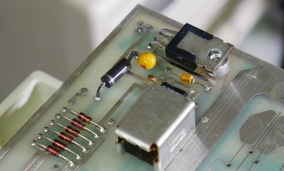

Dammit. I was disassembling the keyboard on my Compaq Portable I keyboard to get at the circuit board to at least type that way until foam replacements get here, but one screw was seized badly. I managed to get it, but something must have slipped and dammit, there went a resistor. I'm including a picture, but it's not fantastic. I see "Z3" on the side, but I'm horrible at identifying components. There are a scattering of these across the keyboard, all look identical.
Soldering will at least be relatively straightforward if I know what I'm replacing it with. If anyone has any suggestions, I'm open to them. I can take pictures of other ones on the board too, to see if I can get the writing at a better angle.

Reply 1 of 12, by cyclone3d
Pretty sure that is a capacitor, not a resistor.

Reply 3 of 12, by Thallanor
Deunan wrote:
My bet is a zener diode. Can you make a better photo of the actual part? Or write down what the markings are, I could tell you what to replace it with.
The component itself has "A3Z3" on it. I can take a better picture when home but my wife's eyes are better than mine (and the board right here in the car as I went to an electronics supply shop who had no idea) but my phone camera isn't great. There are other ones on the board too, all with A3Z3 on them.

Reply 4 of 12, by Thallanor
I think this picture is a little bit better. I hope it's able to help. 😀

Reply 5 of 12, by Thallanor
I'm going down this route at the same time, to see if I can narrow things down. MLCC capacitor? I dunno. I'm just so stumped as A3Z3 doesn't really come up with much of anything. 🙁
Reply 6 of 12, by Tiido
That looks like a axial ceramic capacitor, probably a 0.1µF that litters old mobos.

Reply 8 of 12, by Deunan
Ah, if all of them have the same markings then a zener diode is unlikely. Can you make a photo of some of these other A3Z3s then? That 3-pin part, is it a power transistor or a 78xx/79xx voltage regulator?
Reply 9 of 12, by Thallanor
You guys nailed it! Axial capacitor. Unfortunately, electronics supply shops are going the way of the dodo here so I couldn't find a ceramic capacitor replacement. In fact, I couldn't even find anything closer than 0.47uF @ 250V. I bought a couple and tried my hand at soldering for the first time in 25 years. At least managed to find my old leaded solder. 😁 Butchered the soldering job but did manage to get it in there. And then had a friend point out that based on the transistor, I likely have the polarity backwards. D'oh. But it works - just the capacitor is likely going to let out its smoke prematurely. I went ahead and ordered an assorted 500 pc kit of ceramic capacitors from Amazon for $23 and they should be here Thursday. I'll swap out the capacitor then, since polarity doesn't matter with ceramic capacitors, to the best of my knowledge. In the meantime, it works! Just fun typing on this keyboard without keys right now, until I get the foam replacement kits. But it works!

Reply 10 of 12, by Thallanor
When I carefully lifted it, it was a 78xx. I checked for a friend because he was attempting to determine if I botched the polarity when I soldered in the capacitor. 😀
Reply 11 of 12, by Deunan
My assumption was a zener + power transistor but if that's a 78xx series regulator then the capacitor is 10-100nF non-inductive one to prevent the part from self-oscillating. That's always a risk with any sort of feedback. The cap has to be close to the regulator (and it is) and the "non-inductive" part means it can't be an electrolytic or any other foil-based kind. A cheap disc ceramic will do nicely though - the axial ones are usually higher quality but it's not critical here.
