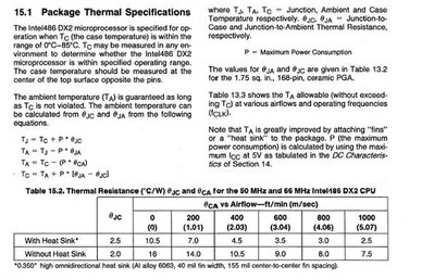

Reply 15 of 39, by PARKE
From the horse's mouth e.g. the Intel datasheet:
97.85 KiB
489 views
https://archive.org/details/bitsavers_intelda … tFeb92_14783795
Reply 16 of 39, by brostenen
So. You actually need 3 meter a second air flow inside the case, before it begins to be safe to run an Intel DX2-66 without heatsink? Below, you need heatsink or even heatsink and fan, or am I reading this correctly?
Reply 17 of 39, by PARKE
There is no mention of a fan but they mention fins on the sink. The key value in this sheet is max. 85 degrees celsius working temperature (which is enough to burn skin in a very short timespan). But I agree with the advise to put a fan on top because, Why not ? The question by OP was if it is needed.
