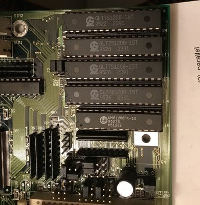

I have a 486 motherboard with some cache.
It looks like the cache ram is 512kb but the tag is a 256kb chip.
So my computer will only see 256kb of ram.
Is the tag ram chip the wrong one for these 512kb. Cache ram chips ?
The motherboard can support up to 512kb of cache.
When I set the motherboard jumpers for 512kb it only sees 256kb.
See photo.

To be clearer, these chips hold 512kilobits
To hold 512kilobytes you need eight of them, but since your board only have four, you only have 256KB.

4 512Kb cache chips make 2048Kb of cache. 8 bits is 1 Byte, so 2048 Kb is 256KB; your cache is fine.

Why do some boards use 5 chips instead of 4 for cache memory? 😕
https://stason.org/TULARC/pc/motherboards/E/E … AY-EV-8038.html
There can be two tag chips. Sometimes it works faster this way.

But actually, there are three tag chips, two bigger and one smaller at bottom 😕

Some boards can take an additional chip to make extended tags for larger cacheable range or in order to enable write back functionality. This 1x64K chip seems to do the latter.

Sometimes some motherboard have 1 chip for tag, and one chip for write-back buffering. 😉 (I have a 386 with that - doubles the memory write speed (Y) )
