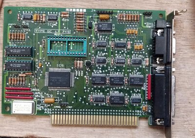

I have this nice CGA card, but the EPROM (ST M2764AFI) has lost its sticker, and when looking at the data in my TL866 I saw that it was totally blank. So the card cannot work without it. Can anybody have that card image their ROM please ? Thanks for helping !

AFAIK, CGA and MDA/Hercules dosn't have own BIOS. All needed functions build in system BIOS. So, in the EEPROM is a font. You can take any from any CGA card.
Or you can just create your own font and burn it in.

Well then where can I find a CGA font ?

you can get the original IBM MDA/CGA one here: http://www.minuszerodegrees.net/rom/rom.htm

I have dumped font ROM from my ATI graphics solution that I know works in CGA mode - but that's CGA+MDA/Herc combo, so the ROM is 8k long and it's a chip marked 2364 so probably a mask-ROM and I have a weird feeling looking at the resulting file that maybe the pinout is not the same as 2764 EPROMs...
EDIT: Yep, it's not. How did I miss the 4 extra pins - must've been more tired than I realized: https://ist.uwaterloo.ca/~schepers/roms.html

That thing is most definitely not a pure CGA card, but quite a bit more powerful.
The Paradise PVC4 chip-set supports MDA, Hercules, CGA and Plantronics ColorPlus modes and your card has the additional 16MHz oscillator needed for Hercules/MDA support.
Your card also has the DIP switches that you'd expect on a hybrid card and the two TMS-4464-12NL DRAM chips have a combined capacity of 64KiB, just like a Hercules card.
If you are going to use this card in a CGA setup, you might find the Plantronics modes particularly interesting.
They are essentially the CGA graphics modes with twice the bit depth, i.e. 320x200 16-color and 640x200 4-color.
While there's hardly any software for these modes, you can still view pictures using CompuShow (CSHOW) and, coincidentally, I have just ported a game – Planet X3 – to it a couple of weeks ago.
When it comes to font ROMs, the Commodore PC 10-III and 20-III might be worth a look, because they use the PVC4 as their on-board graphics solution.
