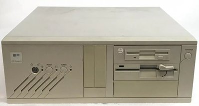

I have an option to purchase an IBM PS/2 model 57 486SLC2 computer.
http://ps-2.kev009.com/pcpartnerinfo/ctstips/5a92.htm
Or a 386dx40 computer.
I always wanted a good 386 computer.
What do you think?
Both are on great condition.
Con’s:
IBM computer is proprietary and rare and expensive
IBM Micro channel (MCA) cards
CPU upgrade is expensive and rare.
Proprietary drives are expensive and rare.
Will be very expensive to own.
It’s loud !
Pro’s:
386 computer is Non-proprietary and easy to fix and find parts for.
Inexpensive to own and upgrade and fix.
ISA slots.

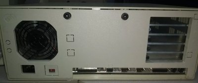

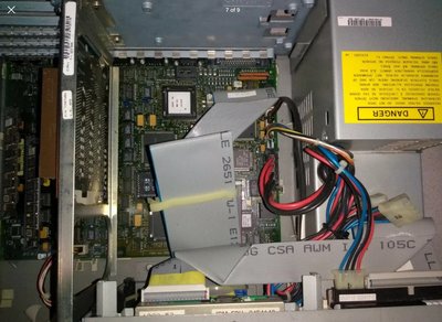

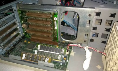

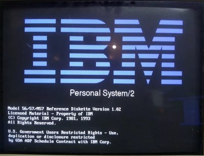

Photos of IBM PS/2 486
Reply 1 of 13, by Intel486dx33

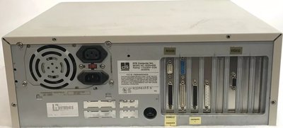

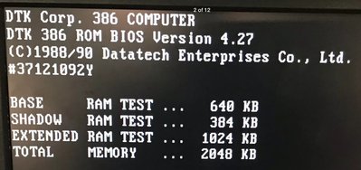

Photos of 386 computer.
Reply 2 of 13, by Anonymous Coward
Both of these systems are pretty nice in my opinion. If you end up going with the DTK, I'd try to track down an AMI BIOs for it though. DTK BIOSes are known to be troublesome.

Yeah, I am kind of leaning towards a good 386 computer that is Non-proprietary.
And quite.
The IBM is Loud and Proprietary and expensive to own.
And the IBM has a 2.88mb Floppy. Do you know if a 2.88 floppy drive can read 1.44 diskettes ?
Adding drives to the IBM would be a big tasks too.
Adding a CDROM to the 386 would be easy. Would you use an Adaptec SCSI card or Sound card with IDE controller ?
Do you know what the limitations or known problems are with the DTK bios ?
I noticed this bios was different.
You mean you haven't tried it yet? Yeah, it works, backward compatibility was the whole point.

With the 386 you can also upgrade the mobo if anything should happen to it. Fitting a cdrom drive to the 386 is a breeze. Also fitting a network card and sound card is a simple job. I use a 2gig BigFoot drive in my 386 using EZBios. Works really well. Not having a 2.8meg fdd isn't that big a deal hardly anything shipped in that format anyway. With the 386 you can use CF cards with the right adapter. Other drive options are external parallel port Backpack CDRoms, LS120 and Iomega drives.Updating the video card is a breeze as well.
No silly setup disks required to sort out the MCA configuration either.

Only drawback of MCA is the allmost unobtainiable sound card, but I am using a Logitech Soundman parport sound adapter with mine.
Network cards for MCA are availiable. Ethernet is sometimes hard to find, but why not setting up a small token ring network?
The 486slc2 is allmost not upgradable due to its 16 bit memory interface, for better CPU upgradability look for a Model 76/77.
The 57 uses industry standard SCSI drives, not the proprietary DBA drives limited to 160 MB the previous PS/2 models use.
A SCSI CD-ROM drive could be easily added, but finding the proper blinds and a original IBM drive could be difficult.
If you are going for an external drive you will require the proprietary IBM 60 pin SCSI cable.
