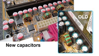

Hello
Abit BF6 Pentium-3(III) Slot-1 motherboard.
How easy would be to change the capacitors in this motherboard ?
- 3-4pcs are bursting soon but all 24pcs probably need changing.
- Dark green and yellow/gold colored capacitors.
Probably same manufacturer as in those bad Pentium 4 motherboards.
Is this a good motherboard or should I trash it because of the bursting capacitors ?
- It has a Slot-1 to Socket 370 adapter and a Celeron 566mhz in it.

It's not hard, and any Abit is worth saving IMO !
And BF6 is a good one too with its Softmenu and "133MHz capable".
If you feel unable to do it pass it on to someone that can =)
Never trash Abits !

So:
- One soldering iron and copper solder-wick ?
Or
- Just pulling them out with those "2-head soldering tweezers" ?
This post had already done it : (6.3V 1500µF)

Reply 3 of 36, by ph4nt0m
[build log] My attempt at building the "ultimate" 440BX machine.
These are 1000uF 6.3V solid electrolytes. He could actually use 4V ones with a higher capacitance on the processor side of the VRM, though even these are an overkill for Slot 1. I would probably install a mix of 1800uF 6.3V low ESR regular electrolytes and 1200uF 4V solid electrolytes.
Abit used Jackcon capacitors usually on their Slot 1 and Socket 370 mainboards. These caps were not great even new.
My Active Sales on CPU-World

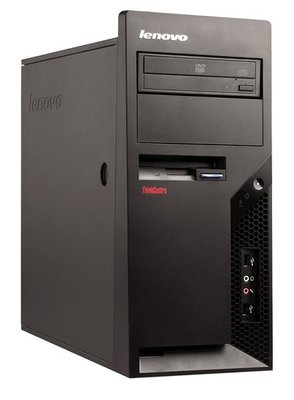

Reply 16 of 36, by user33331
I have extra working Win7 PC\motherboards:
Is it ok to train desoldering with these ? Or are they rare ?
1.) Abit AN8-V socket 939 AMD 2006.
2.) Lenovo's Pentium Core2Duo 2.8ghz Thinkcenter ATX 2007.
    48.11 KiB
    350 views
Reply 17 of 36, by ph4nt0m
You better try some dead mainboards instead. I remember how awful my soldering work looked in my early days back at school. Everything was wrong: solder, flux, soldering iron. The absence of skills makes you use excessive force which is also wrong.
Reply 18 of 36, by BushLin
It doesn't have to be a motherboard you practice on or even capacitors you're (de)soldering.
If you really don't have a better candidate than something working then I'd go for the 939 board purely because it came out around the time when there was a flood of bad capacitors.
Screw period correct; I wanted a faster system back then. I choose no dropped frames, super fast loading, fully compatible and quiet operation.
