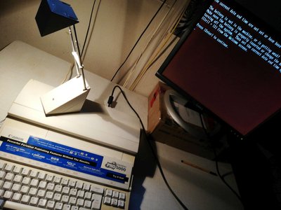

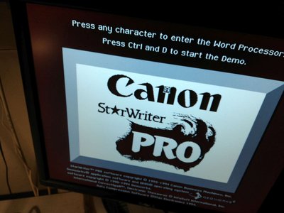

Good eveining everyone,

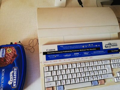

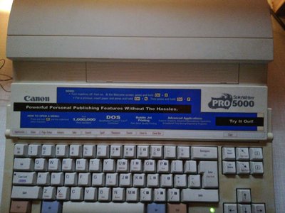

I'm tinkering with an older GEOS machine right now.
It's is running a GEOS 2.x compatible thing, apparently.
I build a new PSU and added new batteries to the battery holder in that "trap-door",
but the machine still complains about invalid time/data due to a battery failure..
Does anyone know how to configure time on such an old beast ?
The Welcome screen isn't really accessible. I also don't own any diskettes for this flavour of GEOS that it has in ROM.
Booting diskettes with PC-DOS (x86) also isn't working.

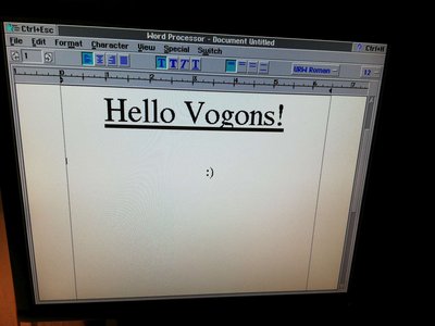

Pressing a random key brings me to the word processor. Sometimes, at least.
The other applications are accessible via CTRL+ESC. "Welcome" never works, though. This causes a restart.
I uploaded a quick video here: https://www.youtube.com/watch?v=M4L9Qg5Gph0

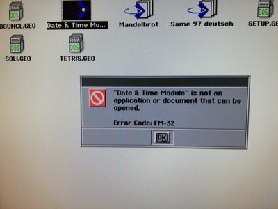

Reply 3 of 33, by Jo22
I made another video that shows what happens if I select "Welcome".
That's the place where I'm supposed to do the configurations, such as setting time/date and so on.
https://youtu.be/7bLsQ5mJqrU

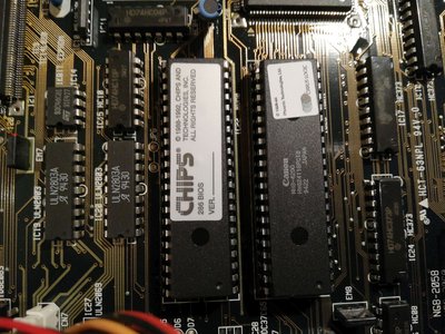

Reply 5 of 33, by Jo22

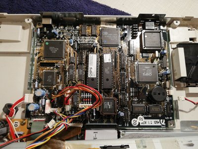

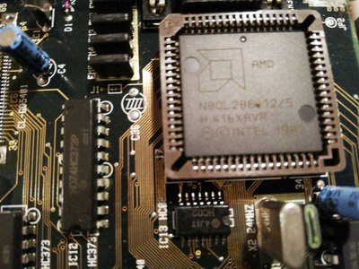

My god, this is no crappy 8088, but a real 80286 computer! 😳
Just checked the internal parts of the machine..:
  • HN62428PE17
    -> 42pin (https://www.datasheetarchive.com/?q=HN62418%2F428)
    HN624116PCT8
    Cirrius CL-GD5401-42QC-8
    2x 81C4256A-70 (256KB 😢)
    AMD N80L286-12/5
    H416XAVR
    intel 1982
    CHIPS F82C235
    T3C79
    BJC NH8-41614
    4L05F8264
    T NH8-4188
    90CM040F-2607
    SMC FDC37C65CLJ P
    2x DRAM HM514800AJ8 😢
I've also taken some more photos iof the "mainboard"..
And a video, too. https://youtu.be/CyJfjqORA-E

Reply 6 of 33, by weldum
it seems to have a standard 286 bios, but it may be a modified one, one solution may be to make a dump of that bios and use it in pcem or something similar to see how it works and how "compatible" it is
maybe is a standard bios, but the os loads the same way as the xt ide bios or the nic card bios

Reply 7 of 33, by Jo22
Yeah that's a good idea, imho!
Unfortunately, these 42pin monsters aren't in the database of my USB programmers (G540 and TL866)..
The other BIOS might be the VGA BIOS for the Cirrus chip..
Btw, I also noticed the keyboard has no Function keys (F).
Maybe this machine is booting diectly to a custom GEOS with a minimal DOS (no command.com) ?
Instead of a having a BIOS at all ?
The battery pack for the clock seems to be fine, at least. 😀
Edit: The Cirrus VGA chip might be a relabled Acumos AVGA1 (256KiB max mem.).
We even have a thread here ACUMOS AVGA1
Some guys video https://youtu.be/tWRSofInqe4

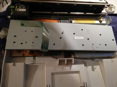

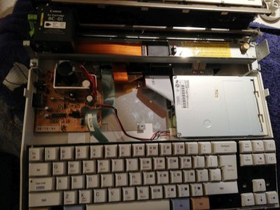

I'll see what I can do. In the meantime, I reassembled the typewriter again.

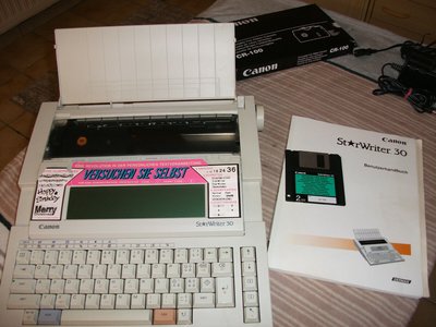

PS: Seems there used to be a separate "Demonstration" disk that I don't have,
The older StarWriter 30 had one like this, judging by a picture that I found on the net.

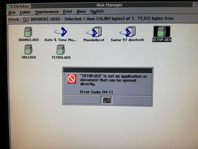

Didnt watch the whole Video, but did you try in the "Disk Manager" the menu "Folder" "Open File/Folder"? Maybe you can enter "\" to access the ROM file system and access some system programs?
Reply 12 of 33, by Jo22
Thanks! ^^ Yes, I tried that. It refuses to display anything without a floppy inserted (just a gray background).
I also can't enter a path manually. 🙁
There's more..
Strangely, though, the 7000 model is said to support *.geo files for GEOS 2.0.
Some guy even claimt to have run his own GEOS games that way.
My 5000 doesn't behave like that. It won't even run Command.com from floppy.
Well, it *tried*, but instantly went back to that defunct Welcome program.
However, I have noticed that the machine accesses the floppy drive during start-up.
It also has a GEOS.INI file placed on the disk. - Iv'e attached that ini along with my sample test (*.000).
Maybe this helps us to find out how to "fix" the machine or figure out what we're at ? 😀

Btw, here's another photo. It shows my custom made "power supply" for the Pro 5000! 🤣

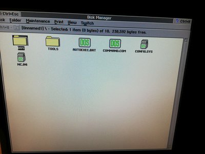

See my ammended post above. The ini file on the floppy disk does absolutely nothing. All my Geos versions just ignored it. If the files posted open it will confirm your setup is Geos 2.* compliant and any docs you create will be compatable with PCGeos 2-4
In you video you show a area there were autoexec.bat and config sys reside, that will be your root directory ie the equivalent to C:\ If you open those files it'll give you an idea how the system is setup. Also in the same place is a *.ini file. That may well be the main config file for your variant of PCGeos or one in the geos or similar directory. You can make copies of them I you like and I'll have look. Just post them in this thread so everyone can have a gander.
Just a wee tidbit. Out of curiosity I wanted to see what would happen in GeoWorks Pro 1.2. The system is running MS Dos 6.2. The damn thing installs alright but needs Dos up to version 5. I tried setver but still no go. Runs on the XT fine using MS Dos 5 and worked on my original 286/16 system running DR Dos 6.0 but of course that reports version 3.31 to programs iirc. Later versions run without issue though.

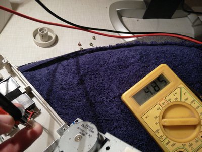

I got this GEOS typewriter without any accesories. Not even a manual and paper for testing.
- That's when I started making a simple AC PSU out of an old transformer (250v to ~13v).
