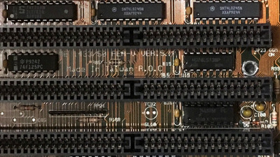

I've had this Biostar 486 motherboard for a while, as you see it is ISA only but has a couple of unpopulated VLB slots:
1.63 MiB
988 views
Biostar MB-1433/50 AEA-V
By looking at some pictures in the web of this board (there are not many), I noticed that the versions that have VLB slots don't seem to have any noticeable difference with mine regarding what components are populated, so I guess none of them are needed for VLB support? Even the jumper for setting VLB wait states is there on my board.
So do you guys think it's worth a shot trying to scavenge some VLB slots from a dead board and transplant them into this one? Or maybe I'm missing some VLB specifics that would prevent this from working? A VLB board would be way more useful to me than an ISA only one!

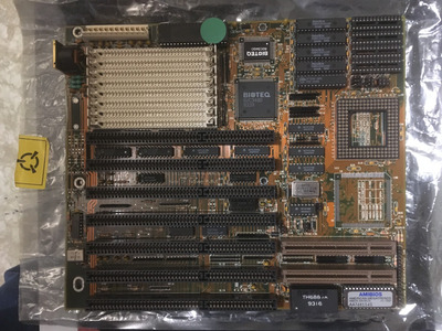

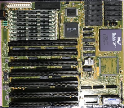

TheMobRules wrote on 2020-01-19, 00:49:
Are there any owners of this board in the forum who could dump the BIOS and share it with me?
Ok found both Bioteq/Biostar boards, one is MB-1433/50 AEA-V VER.5. Has Award BIOS sticker # AA7481545. The other is MB-1433/50UIV REV. 1 and would not be similar to yours. Will boot up the AEA-V board and try to save the bios....
