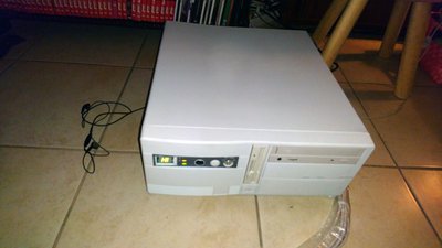

I build recently an i486Dx2 66 MHz (always wanted it back on 1993 - 1995) VLB machine and used an old desktop case (with LED Mhz display, turbo, reset button and keylock) which needed some refurbishment.
The plastics were on terrible yellowish state so firstly I made a retrobright effort without big success, so I painted the plastics and the whole case with success, but I have an issue with the power switch button because of the exposure to the sun heat during the retrobright process the plastics maybe bended a little so the power switch doesn't sit well in it's position. Sometimes works pressing the button, sometimes not, so I'm thinking to add on the back of the case, a pushbutton. Can I do this?

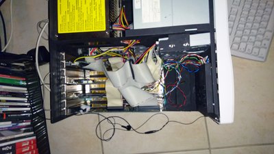

Can you show us a picture of your build? I am curious 😉

Soyo 025N2 (I want to add voltage regulator)
i486Dx2 66 MHz
CL 5428 2MB VLB
ES1868F
16 MB EDO RAM
Compact flash for HDD.
CD Rom isn't connected I don't have a spare IDE cable and I always connect the optical drives on the sound card header.
I will add a 5,25" floppy disk drive soon...
P.S. Sorry for the quality of the images, I need to reflash the firmware on my Z5, I'm using another application. Camera doesn't works well...
P.S.2. You can see the color difference, is not yellowed and the chassis is paint in black... Also the cover is the same color as the front plastic faceplate.
