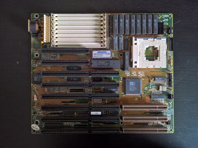

Back in 1993 I had the following custom PC built with all the money I could afford.
It costs me $2500
Specs:
Motherboard - generic chinese socket-3 ISA motherboard.
CPU - 486dx-33
Cache - 128kb
RAM - 4mb.
Video card - Oaktech VGA
Sound card - Sound blaster 16 compatible.
Network - none
IDE controller - ISA generic
Hard-drive - Conner 120mb.
CDROM - Sony 2x with controller
Case - Generic beige AT case of that era.
Monitor - 14-inch SVGA
Now this is not ideally what I wanted just what I could afford or was willing to spend as I was a novice to computers and it was all new to me and I really did not want to
spend allot of money as I just wanted it for school and work to run Windows-3.11
So I want to try to recreate the Ideal computer I actually wanted in 1993.
Here are the parts I am considering but I don't know if all these parts are from 1993.
1993 Hardware PC build:
ISA motherboard
CPU - Intel 486dx-50 ( 5v. )
Cache - 512kb
Ram - 16mb.
Hard-drive - WD-540mb. or Conner-540mb ( because I really like the retro clickly sound of the Conner drive ).
Sound card - Sb-16, Turtle Beach, PAS-16 ?
ISA controller - Goldbond, WinBond, SMC ?
CDROM - I will have to use a 4x speed because those old 2x CDROM's are rare and expensive and unreliable.
floppy drives - 1.44 and 5.25
Network card - 3com 3c509 or Novell NE2000 compliant. ( ISA ).
Case - Generic beige AT tower case.
Display - I have a 19" HP SVGA monitor somewhere in my garage. It's like NEW.
What do you think ?
I have most of these parts already.
What parts should I use to be 1993 retro as possible with CPU and cards ?
The ISA motherboard I have is a generic socket-3 NEW old stock. Like NEW.
I don't know the manufacture date but I don't care too much about the manufacture dates.
I just want the specs of the hardware available for 1993.
Purpose for Build:
To play DOS games and run Win3.11 dual boot.
And have network capabilities.
Best display graphics for that year and Audio.
    513.91 KiB
    837 views
Reply 1 of 10, by SirNickity
Well, I guess that depends on what era of DOS games you're looking for.
In general, I question the point of building 486 ISA systems. If you need the increased computing horsepower over say, a 386... then you also probably need more bandwidth to the video card -- and will stand to benefit from more disk bandwidth as well. Therefore... VLB or bust, IMO. (A shame, because that motherboard is otherwise a nice find.)
Then again, 1993 is a fairly early 486. I had an SX/25 in the early 90s -- ISA, obviously. It did OK with Sierra / Dynamix titles like PQ3, Willy Beamish, KQ6. It didn't take long to hit a ceiling though. My DX2/66 made all the difference, at least for a while. It started showing its age on Duke3D, Wing Commander 4, and >8 channel MODs.
I think you said somewhere that you have Socket 7 systems, so if you're shooting for games pre-FPS craze, and don't have any 386 or earlier systems, I guess an ISA 486 would be an OK place to start. In that case, I wouldn't bother with a 50MHz CPU -- particularly not the DX. A DX/33 would be fine. 8MB RAM is good.
The usual suspects for hardware -- grab an S3, Cirrus, or maybe Tseng ET4000 VGA card. SBPro or clone sound card is fine. Who cares which IDE controller -- what's the difference at that point. Unless you already have a 540MB HDD, you're going to pay a lot for one. Just get a 420MB drive. Close enough, and much cheaper.
