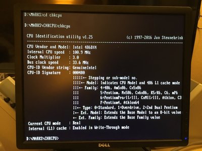

Yes, it does work at 100mhz. You need to remove jumper 37 on the motherboard which controls the CPU bus speed to run at either 25mhz with the jumper on or at 33mhz with the jumper off. And configure jumpers 24, 25, 31 for Overdrive CPU. I have it working with the 64mb of ram and 256kb cache. And 728mb IBM hard-drive.

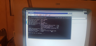

Wow, I congratulate this topic, since it has brought me great memories.
15 years ago I did an upgrade to my 486 with 64mb of ram and a dx2 processor of 66. and with the feat of installing windows 2000 !!. After that it was forgotten.
Thanks to this topic I read yesterday, I started buying all the updates that I missed 15 years ago mentioned here (cache memory). and 100mhz dx4 overdrive.
The only difference I see between the motherboard here and mine is that I have a zif socket to expand the video memory of the cirrus logic chip. Does anyone have knowledge of how this expansion chip could be?
What do I want to do that for? Because I am currently a technological architect. and it all started with this pc that was my teacher and instructor in this way of computing.
Currently with all these new updates, I will give you the use of giving me support in the programming of eeproms to repair arcade plates in my laboratory.
Regards!!

Intel486dx33 wrote on 2020-03-04, 16:28:
Yes, There where at least 6 0r 7 different variants of the IBM PS/1 model 2133. The last one being the Multimedia edition. Which […]
etoromu wrote on 2020-03-04, 15:02:
Wow, I congratulate this topic, since it has brought me great memories. […]
Thanks to this topic I read yesterday.
Regards!!
The last one being the Multimedia edition. Which came with a Sound Blaster Ct1740.
But you can use a CT1770 also.
You may need a 169 pin Intel 486 Overdrive CPU if you have the “IBM PS/1 Consultant” model.
I tried other CPU’s like AMD and they will not work.
And the IBM disk image for 1994.
IBM PS/1 consultant restore.
Thank you very much for the data, I just bought the cache memory and I'm about to buy the overdrive processor.
This weekend I will take pictures of my motherboard so they can advise me in a better way. Thanks a lot!

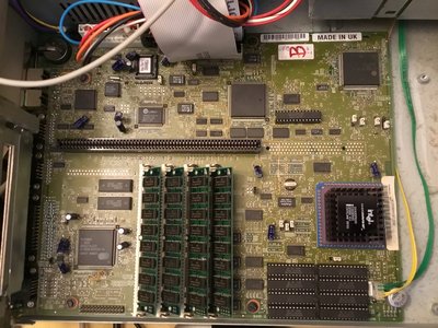

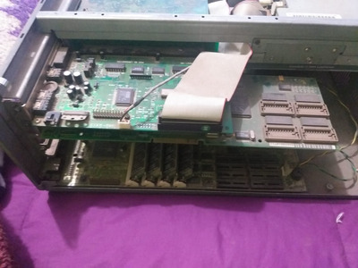

Reply 29 of 66, by etoromu
I could ask my sister to send me some photos of my ps / 1 to share. in them you can see the motherboard and the zif socket to expand the video memory. In addition, I ask if the overdrive dx4odpr100 processor works for this board. Regards!!
    137.19 KiB
    2267 views
    motherboard processor side
    61.98 KiB
    2267 views
    expansion video memori zif slot
    111.23 KiB
    2267 views
    motherboard video chip side
    83.81 KiB
    2267 views
    motherboard
    68.26 KiB
    2267 views
    front

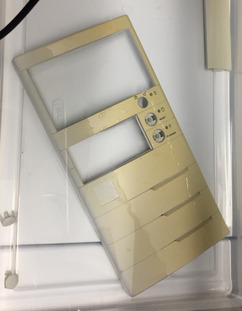

Reply 30 of 66, by SirNickity
Intel486dx33 wrote on 2019-08-14, 23:03:
What is the best solution to clean this yellowed plastics with ?
It’s just the CDROM that has yellowed.

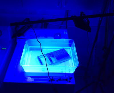

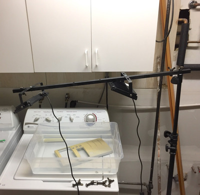

Have you done anything about this yet? I have been tinkering with my retrobrighting setup, and working on restoring a new-to-me AST Advantage! 824 mini tower. Here's my process:
1) It is amazing how much a simple cleaning does. First, I use some degreaser in a spray bottle -- not sure what brand. I can check later, but any household gunk cleaner will do. That stuff cuts through the layers of blech that settles on the case when they get left in a garage, basement, or attic for 10-20 years. After a good scrubbing, it already usually looks significantly better.
2) Next, a little touch-up with a Magic Eraser. Not too much -- don't ruin the texture. Just get those scuffs out, and a little of the grime caught in the texture itself. By now, it's looking presentable, if not color-correct.
3) File or sand down some of the rough edges. If you have a bruise somewhere that left a gouge in the plastic, judicious application of a file, Xacto knife, or a bit of sandpaper can smooth the edges of the defect to where it's not so noticeable. Be careful not to go too wide, otherwise it'll end up a big dull patch instead -- which is not better. Just take down the edge and let the wound disappear under anything less than scrutiny.
4) OK, now about that yellowing... I bought a plastic tub with a footprint large enough to drop in the front panel of my largest case. Then, I hit a couple local home stores and bought out their stock of 3% hydrogen peroxide bottles. They go for about $1 apiece, so 10-15 isn't an unreasonable place to start. Now we just need UV.
My first thought was to get a reel of UV LED strip tape, but that did not work so well. For one, you have to power it. Not too bad, since they usually provide a barrel DC jack pre-connected, and it just needs 12VDC. Easy enough. But, for one, the tape I used was covered in a silicone sealant, making it difficult to cut and solder together with jumper wires. Then, it turns out +12.0VDC is a little too much -- they got hot, started browning the LEDs, and I have no doubt they would fail after not that much use. Finally, I had used the adhesive backing to mount them to the lid of the tub. Predictably, it did not hold, and I lost about 1/3 of the strip when it fell into the hydrogen peroxide and electrolysis'd the jumper wires to corroded hunks of uselessness. So, scratch that idea.
Take two: 8-bit Guy showed some UV panels he got, and it turns out they're readily available on Amazon in just about every configuration you could want. So I got qty. 2 of the 30W panels. They have a built in AC power supply, heatsinks, and a convenient mounting bracket. I used a DJ lighting truss to screw them into, but any old lighting truss you have lying around will do. 😉
225.43 KiB
2254 views
145.35 KiB
2254 views
With 2x30W panels and 3% H2O2, it took about 2 days to get 90% back to original color on a panel I had previously removed from an Enlight case (just a handy test subject that was heavily yellowed.) I've left it in for a few extra days, and it's ... a little better perhaps. I'm not sure 100% restoration is possible, but frankly, the turn out so far is honestly fine by me. I just want to see what was possible.
Here's a before/after shot around day 2:
86.98 KiB
2254 views
97.31 KiB
2254 views
You can get faster results with concentrated peroxide, but let me just say this: It does not appear so far that you can easily overdo it with this method. I value predictability and doing no harm to the product as key criteria. I can wait a week if I need to. I don't want to ruin an otherwise good panel trying to race to the finish line.
I started this process Saturday afternoon, it's now Wednesday afternoon, and it seems to be getting to the point of diminishing returns. I don't expect it will be much better tomorrow, but more importantly, it is not marbling, streaking, or getting any worse. At some point, I will need to do laundry though.

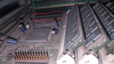

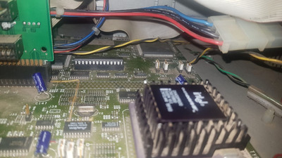

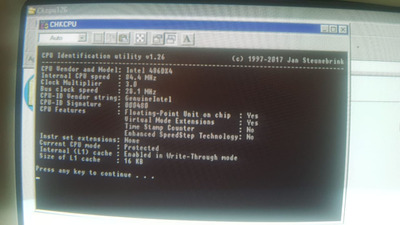

Reply 31 of 66, by etoromu

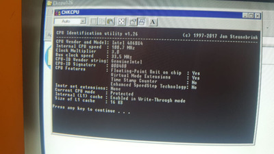

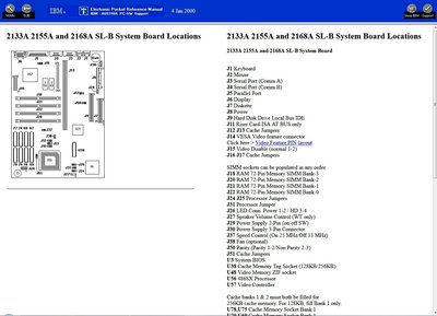

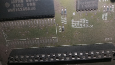

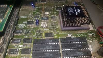

I have a problem with my Ps1 upgrade, the DX4odpr100 without cache memory works perfectly, but with the cache memory run slow.
    1.33 MiB
    2201 views
    DX4 odpr100 with cache memory

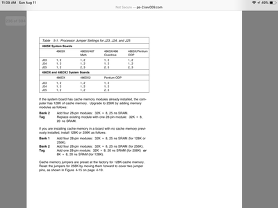

Reply 32 of 66, by Intel486dx33
etoromu wrote on 2020-05-30, 04:00:
Did you set the motherboard jumpers for a 486dx2-33 CPU ?
Did you change the cache jumpers for the amount of cache you are using ?
You also need to enable/disable cache in bios settings.
See manual for your motherboard type and jumper settings
http://ps-2.kev009.com/pccbbs/aptiva/63g2028.pdf

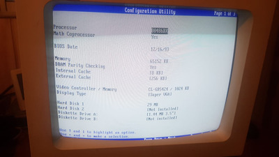

Thank you very much for the help, I have followed the manuals and I have even supported myself with the configuration of jumpers on your board. however the problem persists. I have taken pictures with the cache installed and others where I only removed the tag memory and setting the cache to 0, the processor and the bus work perfectly. I really don't know what else I could do.

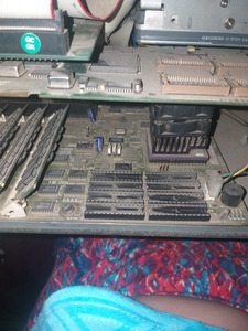

Reply 34 of 66, by etoromu
etoromu wrote on 2020-05-30, 22:18:
Intel486dx33 wrote on 2020-05-30, 07:28:
Did you set the motherboard jumpers for a 486dx2-33 CPU ? Did you change the cache jumpers for the amount of cache you are using […]
The images without tag memory
Reply 35 of 66, by Intel486dx33
CPU setup looks to be working fine. Follow the process of elimination. The Cache chips appear to be the problem.
Do you have other cache chips to test with ?
Look here:
https://www.ebay.com/itm/256k-cache-lot-10pc- … LMAAOSw~w5eU1nw
You can use one for the TAG too.
You should be using all the same chips even for the TAG.

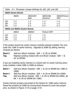

I only have 10 chips that I bought on ebay a while ago, I bought these taking as reference the photographs of your board since they were 20ns. Attached are photos of the ad and one next to me.
Reply 38 of 66, by Intel486dx33
Caluser2000 wrote on 2020-05-31, 01:24:
Can you show me a picture of this mythical 486dx2-33 cpu please?
These computers came with a 486sx-25. The Intel overdrive CPU works best with 486dx2-33 settings.
So he needed to change the BUS speed to 33mhz and CPU type to 486dx2 or Overdrive CPU.

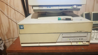

Reply 39 of 66, by etoromu
This is currently my refurbished IBM ps1 2155 CPU, I thank the user Intel486dx33 for motivating me to restore my precious computer again.
