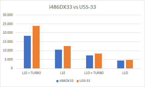

I downgraded my slow 486 system from a U5S to an i486DX over the weekend that allowed me to compare the performance of the chips. My experience is that Navratil NSSI benchmark scores are a very good indication of how strong the CPU is for DOS, so I will just present that data, and you can take my word - it is around 30% faster for sure. Doom for example is playable on the U5S but not at all enjoyable on the DX33.
Hats off to UMC. You guys done good.
