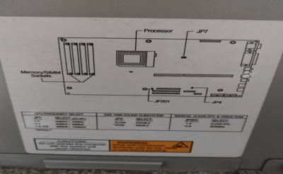

Top of the case has a jumper list but non seem to be for cache. Only the bus speed, onboard ESS, and CMOS.
Bios has nothing for it either.

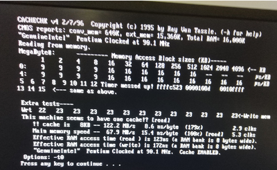

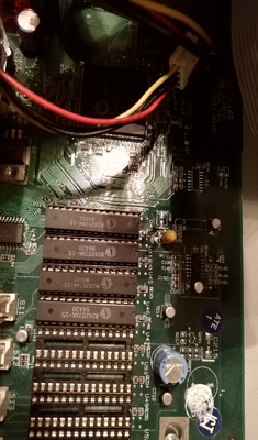

I only have 128k of cache on hand, so out of curiosity i put them in and ran the computer anyway to see if it'd auto-detect them to no avail.
I put one chip in every other slot. I don't think their were incorrect, they didn't feel warm, nor did anything nasty happen. These chips where fresh out of a working 486 board and worked previously.
1.7 MiB
245 views

Reply 3 of 12, by Tiido
Did you also fill the TAG RAM socket ? The tiny photo only shows 8 sockets but there's a 9th one somewhere too that must be filled.

Reply 5 of 12, by Yuuker
Aha yes, i found a 9nth slot. Didn't seem to make a difference however, cachchk still reported no l2 cache.

Im trying for 128k as thats all i got for now. These previously came as a 256k set but a few ended up dead.
It should be 4 on the cache slots and 1 in the tag-socket right? Orientation looks to be correct, maybe their in the wrong order?

Reply 6 of 12, by Tiido
I think the chips need to be in every other socket

Just tried it to no avail 😢
Both cachchk at ctcm7 refuse to acknowledge its presence.
Did a re-scan of the bios and still found no settings for it?. How much performance am i loosing out by not having cache in a p90 anyway?

Reply 10 of 12, by Tiido
"pentium", that's the cruciual info I have managed to miss... Pentiums have 64bit databus which means all the cache sockets must be filled (each chip is 8 bits).

Reply 12 of 12, by Tiido
TAG RAM is probably normal 32K x 8 chip like the other chips so you'll need 9x same type chips. If there was damage you'd know it already.
