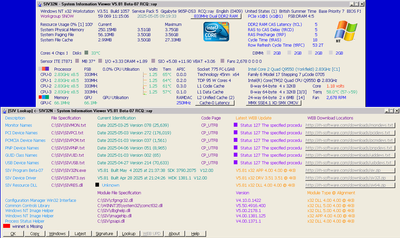

First post, by red-ray
Hi Guys, SIV was coming up to it's 18th birthday and I have been trying to improve the support for elderly CPUs, GPUs and chipsets, but need help with testing.
Running SIV and what I would like
  1. Simply running SIVxxx.exe should work, when it does please post the initial screen shot.
  2. Assuming SIV starts OK I would like the save files generated do doing Menu->File->Save Local so I can check things in detail. I am happy for these to be posted, PMed or emailed.
  3. If one of the save sections has an issue do Menu->File->Save->Save Selected and deselect that section before pressing [ Start ].
  4. If you spot any incorrect information please tell me what it should be.
Minimum System Requirements
  1. SIV works best with Windows NT 3.51 and later with rather less being supported on Windows 95 and later SIV32O just about works on NT 3.10 , but NT 3.10 does not have all the API functions SIV needs to work well.
  2. >= 32 MB of memory is sensible, 64 MB for WNT, but SIV32L has worked on a 4 MB Windows 95A system, it did not use SIVRES.dll + PCIDEVS.txt so the logos and PCI descriptions were absent.
  3. For pre Windows 2000 you need to use SIV32L.exe or for NT4 you can use SIV32N.exe. The latest beta is available via Menu->File->Latest Releases.
  4. For Windows 2000 and later SIV32L runs OK, but it's better to use SIV32X, SIV64X or SIV64I.
  5. SIV32L should run without any of the other files, but the item descriptions and/or images will be missing. On NT systems you should not delete the drivers (.SYS files) as this will limit what SIV can report.
  6. By default SIV uses the Tahoma font which may not be installed on old systems. If it's not present SIV should still work, but I have attached a copy you could install.
  7. DBGHELP.dll +PSAPI.dll are absent from most NT4 and earlier systems so ideally copy the attached ones into the Windows NT system32 directory.
  8. If CFGMGR32.dll is missing from your Windows 95 system use one within the attached CFGMGR32-W95.zip, use Menu->Help->SIV Lookup to make sure it's being used.
  9. If MSVCRT.dll is missing you will need to install the attached vcredist_60_x86.
  10. For native x32 Windows NT 3.51 systems SIV32O should be used, but if you have the NewSell installed then use SIV32N.
Systems and GPUs I would like to test on
  1. SIV is designed for Windows NT so if you have both Windows NT/XP and 9X use the NT/XP system as more will be reported. Chances are that if something is zero or absent on 9x/Me the correct value will be reported on NT 3.51 and later.
  2. As Windows 9X does not support kernel mode structured exception handlers (__try { … } _except() { … }) in VXDs SIV can't sensibly use a VXD to read MSRs so struggles with Pentium III and later CPUs on Windows 9X.
  3. Any system with a pre Pentium Pro CPU, especially none Intel ones.
  4. Any system with a 3dfx Voodoo Banshee, S3 Savage + Trio + ViRGE or XGI Volari GPU. In general if SIV does not report the GPU Clocks on Windows NT/XP I will try and add them.
  5. Any Windows NT/2K/XP/... system with NVidia 6000 series or earlier (NV3 to NV44) GPUs. SIV will not report NVidia clocks on Windows 9X systems.
  6. Any pre Pentium II system with multiple CPUs especially an ALR 6x6 and systems with >= 4 CPU sockets.
  7. Any ASUS L1N64-SLI WS or /B system, ideally one with four core CPUs.
  8. Any DEC Alpha (http://en.wikipedia.org/wiki/DEC_Alpha) system, use the native SIV32A. SIV32N will run, but rather slowly.
  9. Any PowerPC (https://en.wikipedia.org/wiki/PowerPC) system, use the native SIV32P.
Generating logs if there is an issue with SIV start-up.
  1. If SIV does not start from a command window do SIVxxx -DBGINI -DBGTIM > SIV_DBGOUT.log | more which will trace the SIV start-up to SIV_DBGOUT.log which I need to be able to figure out the issue
  2. If there is an issue with [PCI Bus] do SIVxxx -DBGINI -DBGTIM -DBGPCI > SIV_DBGOUT.log | more
  3. If there is an issue with the GPU Information do SIVxxx -DBGGPU > SIV_DBGOUT.log | more
  4. If there is an issue with Disk SMART Monitoring on do SIVxxx -DBGSDM > SIV_DBGOUT.log | more
Thank you for all your help.
The latest SIV release can be downloaded from http://rh-software.com/ and using it Menu->File->Latest Releases will allow betas to be downloaded.
