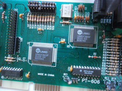

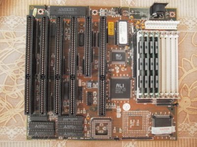

Hi guys, I have a 386 40MHZ Soyo 019R1 board. Upgraded the ram from 4 to 8mb, has a Trident 512kb graphics card. It runs DOS and Win 3.1

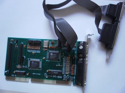

Last 2-3 days I am trying to add a CD rom. My oldest one is a 16x Mitsumi from 1997. IDE is on IO card, no ports on the board. I am struggling to get it working, system dont recognise it. I dont know the jumper setting of the IO card, found PT 606E and PT 606G manual, I have a PT 606V... Tried the jumper setting of PT 606E which looks exactly like my card. Also tried to disable IDE master and connected the HDD with an old type of cable which has only 2 ends no connector in the middle and DOS just starts up normally, so I think manual is not good for my card or I am just too dumb to figure it out how to get the CD rom recognized by system... Tried master, slave cable select. Tried both ends of cable. Tried to find it in bios... Waiting for some advices or tips 😊

The IDE port probably does not support ATAPI. There's a reason why most CD-ROMs up to 1994 used a proprietary interface (or SCSI). IDE without ATAPI does not support anything else than hard disks.

Try writing a DOS bootdisk that has CD support and boot from that to test if the drive is being detected correctly. Then you'd just need to copy the driver & executable (ie. mscdex) over to your C drive and configure them in config.sys & autoexec.bat
Reply 5 of 13, by Anonymous Coward
The windows 98 bootdisk has ATAPI CD-ROM drive support, but all you need is the OAKCDROM.SYS driver and you can stick that in the config.sys of a regular DOS bootdisk.
Reply 6 of 13, by maxtherabbit
BIOSes in pre pentium systems do not detect CDROMs and, here's the important part - it doesn't matter
The DOS CDROM driver (I recommend VIDE-CDD.SYS) will scan master and slave on both channels and pick up the drive.

This is correct. ATAPI is implemented by the driver; the BIOS doesn't need to detect the drive. Some drivers support as many as 4 IDE interfaces when looking for an attached drive. The reason SCSI and proprietary interfaces were common in this era was because the systems didn't necessarily even have available IDE ports. ATAPI support in BIOS enabled "detecting" CD-ROMs (mostly cosmetic, since you still need a driver) as a coincidence along with supporting larger modern hard drives.

Under DOS, regardless which interface you use, you still require a device driver to recognise the CD-ROM drive.
Since your CD-ROM is from 1997, it most certainly is an IDE interface but, could possibly also be SCSI?.
Just be careful in hooking up your 1997 Mitsumi IDE drive to an older sound card from 1991-1992 that still used the proprietary Mitsumi interface. They are not compatible with each other.
