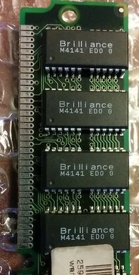

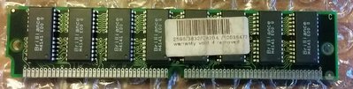

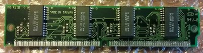

Have you ever seen unsymmetric 72-pin ram? I have now this 72 pin EDO ram module.
But i can't find anything about it...

Should be a 16MByte stick with parity chips (those 4 chips at back)
Indeed.
From what I can remember, symmetric SIMMs were more a later Pentium thing and generally speaking one could say that the older the RAM sticks are, the more weird they will become 😜
There was a lot of stuff going on back then.
