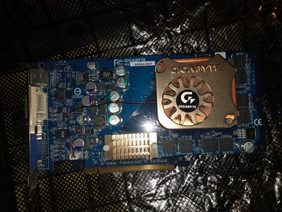

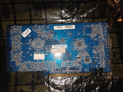

Reply 44 of 121, by j^aws
So I found my PCX 5750 and PCX 5900. Can't locate the PCX 5950 and now I'm having serious doubts to its whereabouts... Hmm. I tried going back to my eBay buying history to give me a clue, but this only goes back to 2017 and nothing further.
In the meantime, here are pics of the NV35 based PCX 5900:

I wonder what drivers I could use and how much it could overclock...
