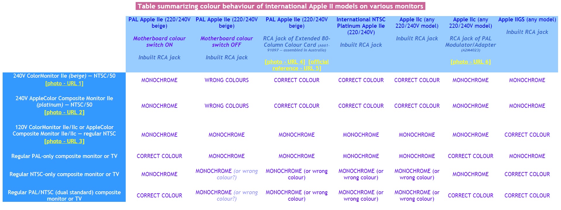

Reply 15 of 16, by c_melody
Here's an attempt to tie together all I've been able to figure out concerning these monitors (!)
btw I believe there is also an ultra-rare 240V AppleColor Composite Monitor *IIc* version - but I've yet to encounter one in the wild
⇒ URL 1
⇒ URL 2
⇒ URL 3
⇒ URL 4
⇒ URL 5
⇒ URL 6
