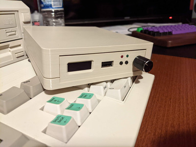

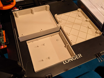

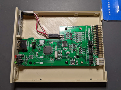

I'm using a Longer LK5 Pro for large PLA prints, and my super old Powerspec 3D Pro for ABS prints.
The prints below are with Jessie Amiga 500 color PLA.
Printed a floppy housing + Gotek 3.5" bay tray on Chrismas day.
Enclosure: https://www.thingiverse.com/thing:4754335
Gotek tray: https://www.thingiverse.com/thing:4760666

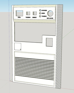

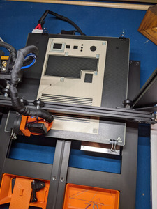

And printing this right now.. Baby-AT case I designed in Sketchup yesterday. It is just the front panel. The 5.25" + 3.5" bay holder that mounts to it is almost done too -- I just need to get the screw hole placement put in the 3D model. Size is roughly 275mm tall by 175mm wide. The back side has holes for 10mm 6-way cube mounts that will be super glued in place, then lexan/acrylic will be what the rest of the case is made from. It should hopefully go together pretty easy.

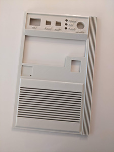

It printed nice.. however a few of my dimensions are a millimeter or two off. Need to revise the design slightly, then it will all fit.
Looks great! What filament did you use?
