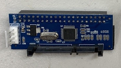

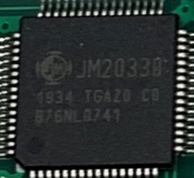

Here is what I've seen for Sata IDE Bridges
IDE Controller to SATA Drives
JM330 -- I don't have one of these
JM20330
27.46 KiB
1874 views

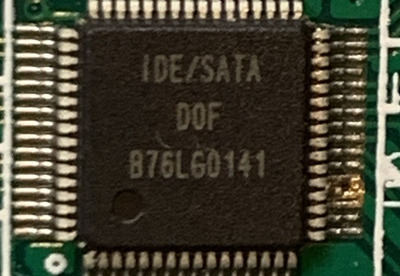

IDE/SATA DOF
86.57 KiB
1874 views
The performance between adapters using these chips was within the margin of error in my testing. (Tested using speedsys)
I've seen it implemented lots of different ways:
  • 40 pin female to Sata cables
  • 40 pin male to Sata connector
  • mSata to 44 Pin Male
  • M2 NGFF Sata to 40 Pin Male

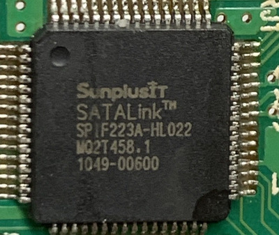

SunPlusIT
SunPlusIT
103.08 KiB
1874 views
I've only seen this in the plastic encased module that has 40 pin female, Berg power connector, Sata cable in, Sata Cable out
Performed 5-10% slower than the JM20330 or IDE/SATA DOF

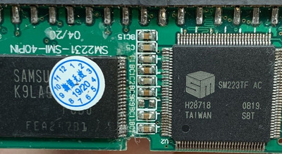

For the DOMS, I've seen 2 controller chips:
SM223TF that supports up to UDMA4

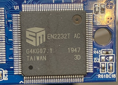

EN2232T that supports up to UDMA6. Had some compatibility issues with some early EIDE controllers, but fine with original ATA or UDMA5 controllers

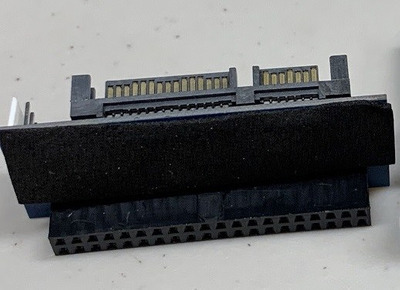

So you have a DoF adapter that goes from a sata drive to an IDE controller? I have not seen one. Are you able to post a pic?
I've seen some DoF adapters that have 40 pin female, but I thought those were designed to sit on a motherboard. Didn't think they would let you go from a sata motherboard to an IDE drive. But then I never tested to see if it would work.

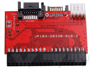

Looks exactly like this. I have successfully used it both ways, with an 80 GB Hitachi SATA drive on two IDE boards (SiS 620 and VIA 686B), and a 40 GB Maxtor IDE drive on a modern SATA system (AMD B450).
This is the one I have always used, both red and black PCB. Works well, no IDE cable required!

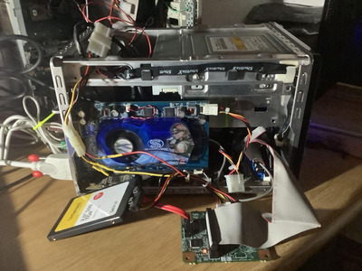

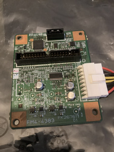

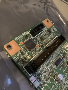

Hi,
no problem.
i just need to open up my pentium mmx.
here some picture:
158.45 KiB
1316 views
i just need some time to do it!

TY. No rush, I'm just curious . I somehow managed to miss this thread during my trial and error runs with various SATA to IDE adapters.

The Converter is used in gambling machines / arcade equipment and also industrial machines.
It works even in my 286-10 with SATA Dom .

Thank you.
Unfortunately it looks like the kind of adapter that I am only likely to find in a decommissioned retrofitted Canon commercial grade copier/printer or something similar, unless I get lucky .
