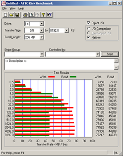

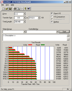

At this point, I am pretty convinced that UDMA 4 default in my setup is a BIOS limitation .
I have tried 3 different IDE to SATA adpters
- a Jmicron JMD330 based no-name adapter (may be branded, but not on the PCB, so I really don't know as I junked the box a long time ago)
- a Jmicron JM20330 based SinLoon branded adapter
- a Sunplus SPIF223A based Startech branded PATA2SATA3
All of them work fine in Windows 98 SE using the Intel default .inf "drivers" that rely on ESDI_506.PDR (I am using the BHDD31 patched version for LB48 support) and default to UDMA 4 (ATA66) once DMA is enabled .
All of them have comparable performance using either the aforementioned driver or Intel Application Accelerator (IAA) 2.3. See below an example when running ESDI_506.PDR based drivers :
12.5 KiB
1375 views
All of them will only use UDMA 4 as a max when using UDMA2.SYS under DOS (even if /M5 is used)
All of them pass SMART (tested with Speedfan under Windows)
Only the Jmicron JMD330 and Jmicron JM20330 allow TRIM to work under DOS
Specifically when using Intel Application Accelerator (IAA) 2.3 :
All of them are unstable and can easily crash HDTACH 2.61 and/or generate corruption whether running at UDMA 5 or UDMA 4
All of them have weird slowdowns when reading at larger block sizes in ATTO (whether at UDMA 4 or UDMA 5) and are at best only about 10-15MB/second faster in UDMA 5 mode than UDMA 4 . Here is an example at UDMA 5 .
12.73 KiB
1375 views
I have no idea why IAA is unstable on my setup, but even if it was reliable, I would not see much of an incentive to use it considering the limited write speed gains and significant read speed slowdowns .

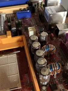

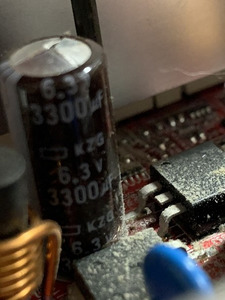

Anyway, my M7 MCG 400 mobo didn't like getting woken up from its long slumber.
55.76 KiB
1256 views
I guess those 6.3v capacitors were not meant to last.
But it matches my Geforce 6100-M9 board now =)
74.18 KiB
1256 views
And my K7T Turbo too!!
81.02 KiB
1256 views
I've been dreading this part of my retro reclamation project. I've entered the age of the puffy capacitors.
Time to improve those soldering skills.
