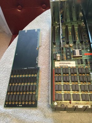

I'm wondering if anyone can help me with this card.
it's an Everex RAM 8000 AT EV178
My woes are in the software for this card, I'm hoping that someone has archive of the EV178.exe that is used to configure the eeprom on this card.
I have tried the Archives of the software for other similar cards that I can find, such as the 3000 and 10000 cards from Everex.
http://www.vcfed.org/forum/archive/index.php/t-34252.html
this old forum post is about the most information I've been able to find, unfortunately I don not have an EEPROM programmer nor do I know how to use one 😒 besides I'd rather not have to desolder the eeprom from the board.
if anyone has any suggestions it would be much appreciated!

What IC do you think is the EPROM here..? Dont see any on your picture?
I'm told it's the small IC between the large main chip and the DIP switches.
my life runs on X86
Reply 5 of 16, by Predator99
Ah OK, cannot read the label. Does not look difficult to desolder as last chance...maybe you can already try to find out the current configuration and if you can use it without modification.

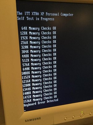

Tell ya man, you couldn't have picked a harder card to find a driver for. 🤣 I have looked at all my FTP haunts and nada thing. I hope you do find it eventually. I had an ITT Xtra XP XT/AT hybrid clone system that had a VERY proprietary memory card in it (pictured below) and without the ITT driver it was completely useless. It was frustrating to see it count all that extra memory at post and then not be able to use it. Ugh. I actually am glad those days of early PC hardware are over. Total pain in the butt.
