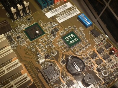

This is my first topic here, so I may as well tell a little about myself. I'm 34, and I've been into computers since I was 10 years old, but I've only been able to work on them since around age 15 (1999). Before then, I had access to a 386 with a 387 co-processor, but I knew nothing about it beyond the fact that it couldn't play Doom. It wasn't until around June of 2000 that I got myself a Tyan 440BX motherboard, and a slot 1 Celeron 433 when things really started to take off. Anyway, Since then I've always had an affinity for slot 1 and Pentium II/III processors.

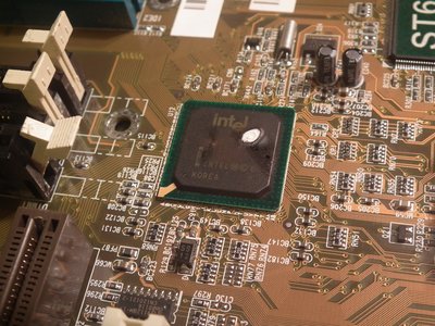

Fast forward to today, and I have retro computers ranging from Intel 486 DX2 66 to Pentium III-S 1.4GHz. Unfortunately, this post is about my best Socket 370 system that I had. I woke up one morning smelling something that reminded me of the heating element in my water heater burning itself out again, so I chalked it up to my imagination, because there's no way that a water heater died again after only 6 years. After coming home and deciding to take a quick nap, I woke up to the smell of something that was about to catch fire, and noticed that my Abit ST6-RAID computer with a PIII-S 1.4 and a GeForce FX 5900 Ultra had turned itself on. The fact that nothing was attached to this computer except for the power cord immediately threw up red-flags for the power supply.

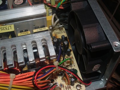

I just removed the cover for the power supply and noticed several bulging capacitors and a lot of black charred spots on the circuit board, so I assumed it was simply a failed power supply... I couldn't have been more wrong. I replaced the power supply (Allied model AL-A400ATX with 28A @ 3.3, 40A @ 5, and 17A @ 12) with a known good unit, and the system turned on instantly with the power supply switch and of course it didn't post. I removed everything from the computer, and that's when I noticed that a small chip near the CMOS battery had literally exploded. I didn't think that was too bad... I do have a second Abit ST6-R that just has bad caps, so it could be used as a donor. Then I noticed that the southbridge looked like it had almost become molten plastic...
I have 2 other systems using these Allied power supplies, Should I dismantle them before they all start trying to burn my house down?
    799.92 KiB
    3087 views
    Bad capacitors in the power supply

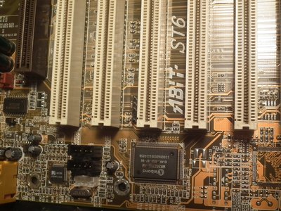

    Winbond hardware monitor also looks like it was about to go up in flames

    Molten southbridge

    Melted southbridge and exploded U19

That charred area is responsible for +5V standby voltage regulation, purple wire coming from there confirms it. Perhaps an electrolyte, that leaked from el. caps, reached the primary, high voltage side of a SB transformer. Any voltage, higher than 5V, would easily damage semiconductor logic on a motherboard, that is responsible for a soft power-on. I can see that one of the caps in that PSU is of a "CapXon" brand, which is infamous for being called "CrapXon" for its poor quality.
There is nothing wrong in using period correct PSUs in old PCs, as long as you can identify possible hazards that may cause it to fail in the future. A well designed old PSU is just as reliable as any modern, good brand PSU. Personally, all of my old systems are using period correct PSUs. You may want to recap those "Allied" PSUs with known good brand el. caps, because it's just a matter of time when they'll fail in a similar fashion.

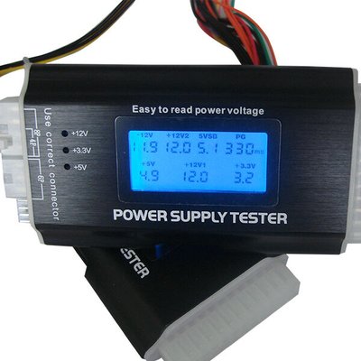

Many of the early ATX supplies were cheap junk and then you have bad capacitors that came later. You should pop the cover of an old PS and look for bulging caps and then test the supply with a PS tester that has an LCD for voltages (under $10 shipped on ebay) before you use it with a vintage machine.
