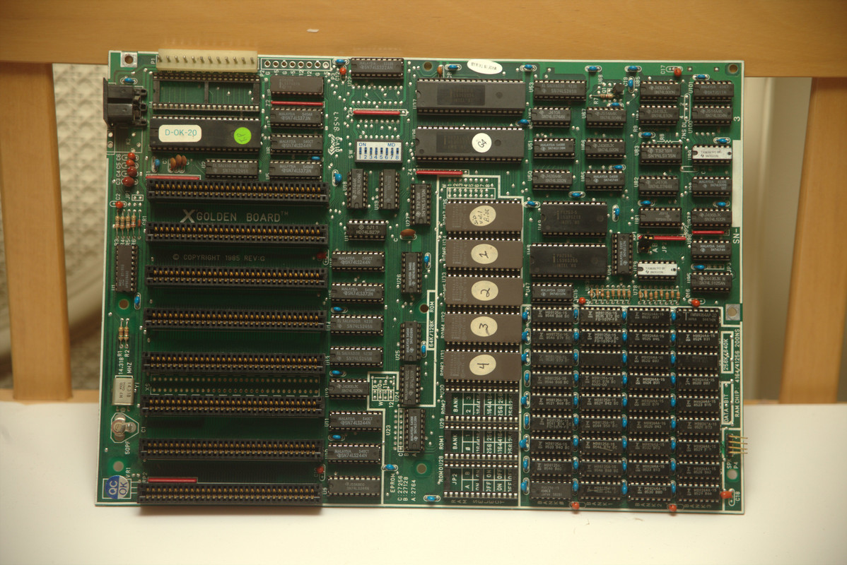

Any info would be appreciated. What is the pinout of this power connector? Thanks in advance.

Pretty standard XT class alright. Clean it up, add a vga card, connect a monitor up, XT compatible kb if you have one, hook up a generic multi i/o card with 1.44meg drive attached and a 720k fdd boot disk, hook a known good AT PSU up turn it on and see what happens. looks like hit has 4 Basic options roms on it which is handy.

I'm confused because it doesn't look like a standard PSU connector that I know. The shape of the pins are also incompatible: one is flat-rectangular and the other is a square. It will 100% not attach to this board even though the pins are there.
Attached a better quality example image of someone's board.

Reply 8 of 20, by jesolo
I have similar XT boards. The connector is a bit different but, with some slight force, you can connect an XT/AT PSU with the standard connector to it. Just make sure of the orientation.

Reply 9 of 20, by Miphee
I'd rather find a PSU that fits this connector. XT boards are very scarce here, even generic clones.
Besides it's the period correct thing to do if I want to build an IBM XT clone but I need info.
Can't find anything about this connector type. Nothing on pinouts.ru either.
Reply 10 of 20, by PC Hoarder Patrol
Think I see what you might mean - apart from the square pin profile, does the moulded part of the male P8P9 connector on the board have a full length securing lip instead of individual locating holes for each pin? Side view something like this:

Reply 11 of 20, by Miphee
It's full lip secured. If the pinouts are identical to the standard P8P9 connector then I can just solder in a standard socket I have lying around.
But that's only as a last resort.
It seems that it was fairly common in XTs and early 286 boards.

Reply 12 of 20, by Miphee
Found one in my desoldered pile. Connector dimensions and spacings are identical.
A standard PSU's connector (P8P9) went in after using considerable force like Jesolo suggested it. If the pinouts are OK then it's acceptable.
I'm still curious about this connector and the correct PSU that fits. Any ideas?

Reply 13 of 20, by jesolo
Early OEM cases used this type of connector with their PSU's but, the pinout is identical to the standard P8 & P9 type connector.
I've come across the same problem with my XT motherboards.
However, if you are in doubt, then test the voltage output with a multimeter on the relevant pins. You'll see it matches the standard P8 & P9 pinouts 😀
Reply 14 of 20, by FAMICOMASTER
This looks like a copy of a copy to me. DTK Turbo 640, an extremely common board, has an identical layout.
Settings and stuff can be found here: http://www.uncreativelabs.de/th99/m/C-D/30501.htm
Manual can be found here: http://www.minuszerodegrees.net/manuals/Turbo … ion%20Guide.pdf
Looks like the DRAM type jumpers are hardwired instead of being populated here, so you're stuck using one memory configuration. Not much of a problem, honestly, since you've already got it fully populated anyways.
Would love to see a dump of what's on those expansion ROMs, though, both of mine just had the one 2764 EPROM, never seen one with more than one or two of it's ROM sockets full!
Those are standard XT/AT power connectors. This is a cheap Taiwanese board, and it was meant to go with it's cheap Taiwanese power supply. The supply is 100% identical to an XT's supply, maybe a bit beefier and with a slightly different connector on the end, but it's really nothing special. The pins of the PSU go really easily onto my IBM AT board and just fine onto the DTK board, but plugging the AT's supply into the DTK, even though the machine works and will boot just fine... It takes a bit more upper arm strength than you'd expect. I always thought it was the plastic lip, but I guess the pins might be different.
Reply 15 of 20, by Doornkaat
On this picture the rails are labelled. Looks standard AT to me.
But if you want to make 100% sure why not check for continuity with the power pins in the card slots like it's already been suggested?

Reply 16 of 20, by Miphee
Thanks for all your help, I'll check continuity when the board arrives.
I have never seen a PSU with a power connector like this so I was naturally curious. I don't like forcing things together to make them fit. It's a common board but not in Hungary. 😁

Reply 19 of 20, by stamasd
This looks like it's pretty much identical to the XT clone I have. Here's a pic:
I have the original manual which I scanned:
https://www.dropbox.com/s/ova9lr4nf7apmpd/xt- … rboard.zip?dl=0
And here's a link to a thread I had a few years ago on vcfed about building it and pimping it up. Unfortunately most of the links are broken now.
http://www.vcfed.org/forum/showthread.php?484 … ebay-components
It takes a standard AT power supply, though the pins being rounded and not flat it's difficult to plug it in.
